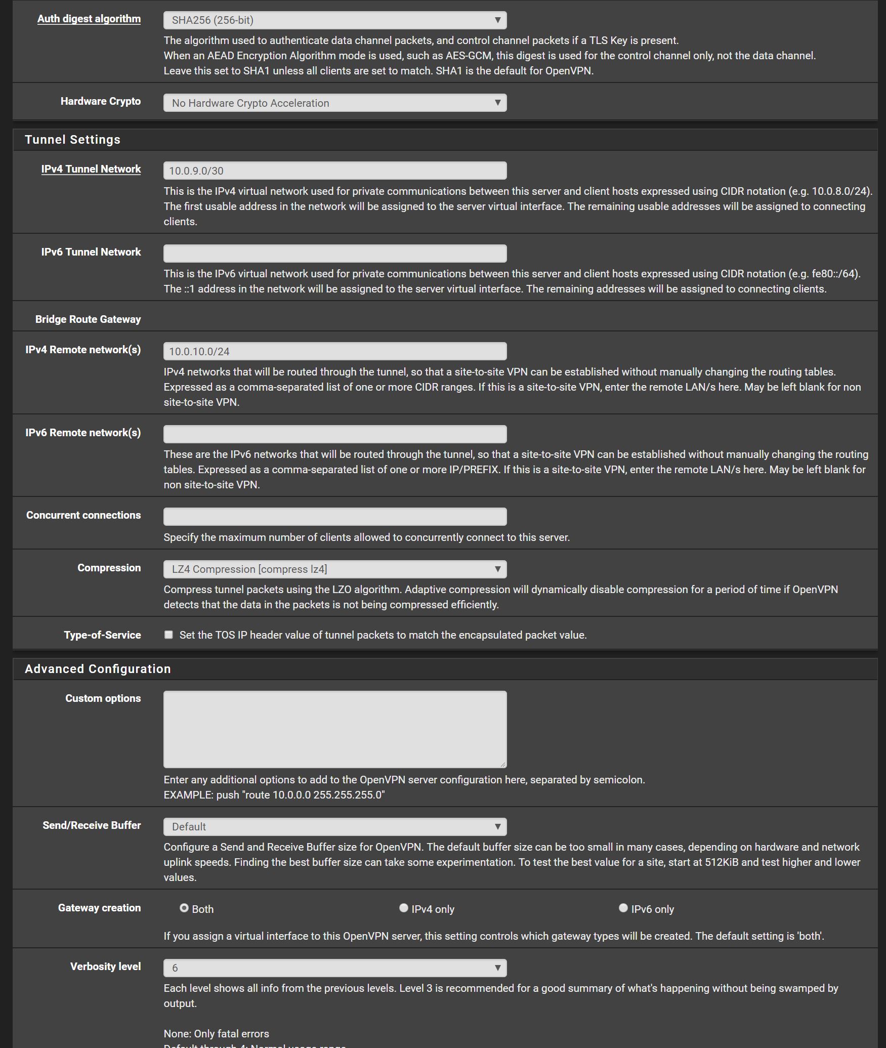

• networks behind 2 OpenVPN servers don't see each other
    Thank you, You steered me in the right direction to double check all my routes. I fixed the problem by replacing push "route 10.0.9.0 255.255.255.0" with route 10.0.9.0 255.255.255.0 on Site-To-Site connection server side. I guess I put it there by mistake. For anyone readying this in the future here are additional steps to make this work: Site-to-Site: server side: add route 10.0.9.0 255.255.255.0 to "Custom options" field client side: add 10.0.9.0/24 to "IPv4 Remote network " field (in addition to 192.168.1.0/24) Remote access: server side: add push "route 10.10.0.0 255.255.255.0" --> will probably work without this if you route all traffic via this tunnel from the client.
