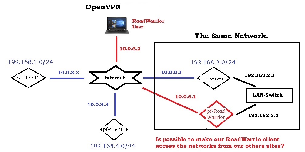

    That's possible though by adding routes, however, I'm wondering how your road-warriors can communicat with LAN devices when your LAN use another pfSense as default gateway. To you use TAP mode or NAT?

  • SitetoSite and RoadWarrior Communication?
    807 Views
    perikoP
    @periko said in SitetoSite and RoadWarrior Communication?: 10.0.7.0/24 viragoman is working, thanks for your great help!!!
