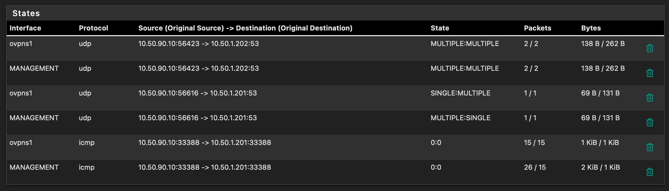

  • OpenVPN Issue - Multiple Interfaces Not Functioning Simultaneously
    878 Views
    N
    @viragomann These public ip addresses are my vps where openvpn is installed. Yes. Yes. [image: 1687872474107-752fda1f-875d-4f38-8e28-bf917811b24e-obraz.png]
