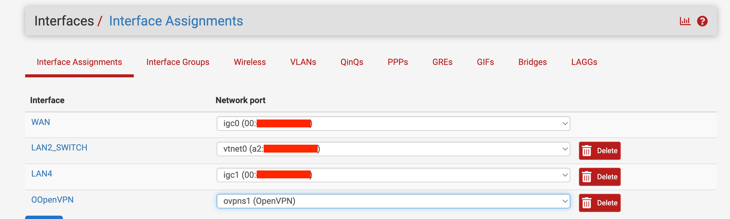

  • Ghost-like firewall tab (OpenVpn) and how to delete it
    876 Views
    L
    Ah I see. Perhaps in my previous setup, the OpenVPN server wasn't assigned to an interface! Thanks everyone for the explanation!
