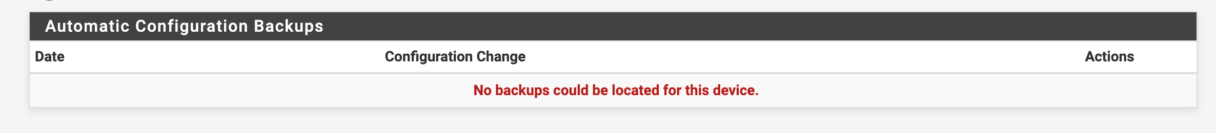

• Automatic Configuration Backups all missing
    756 Views
    Yes, should be good now. Let us know if you see any further issues. Steve
