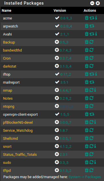

    I used the 'Reinstall all packages' button from Diag > Backup & Restore for this on the my edge box. No problems I noted. Steve
