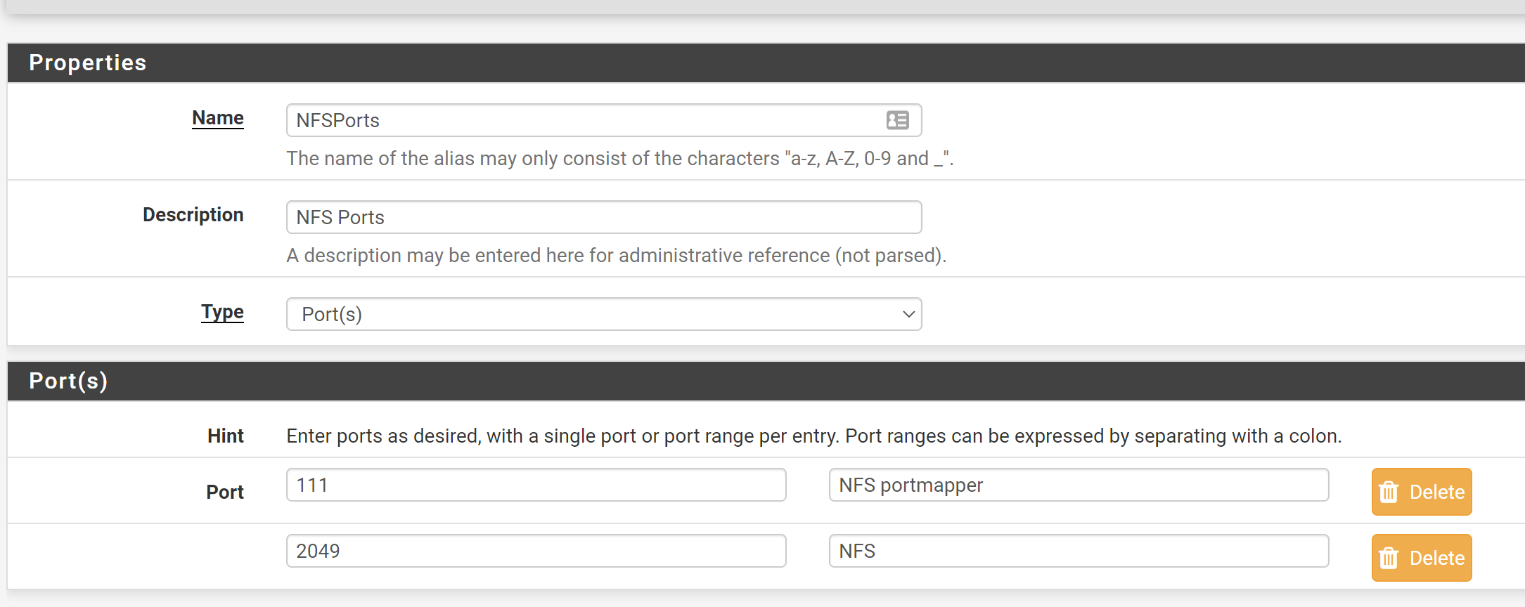

    kiokomanK
    you also need mountd port under ubuntu it's sudo nano /etc/default/nfs-kernel-server RPCMOUNTDOPTS="--port 12345" sudo systemctl restart nfs-kernel-server rpcinfo -p | grep "tcp.*mountd" open port 12345 on pfsense
