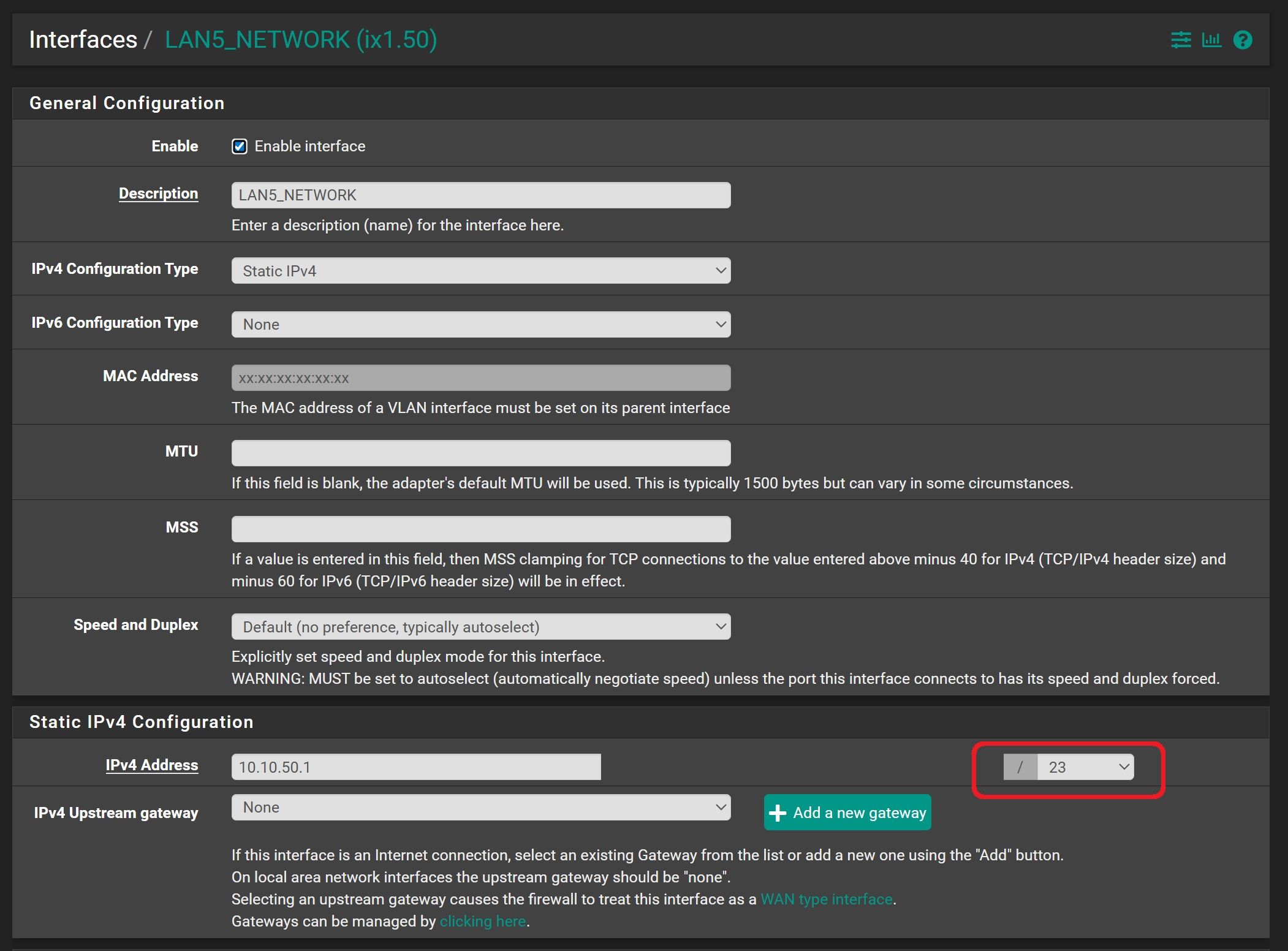

    ARAMP1A
    @stephenw10 said in Subnet Mask Update: You need to set the subnet mask on everything static in the subnet. You probably still have somethings set to /24 creating route asymmetry when they try to use their gateway instead of sending directly. Everything appears to be working correctly now. I think this was it. I have an UnRaid server that I thought I changed the subnet mask but it didn't change. Actually have to stop the array and change it. After doing this, I'm back in business!

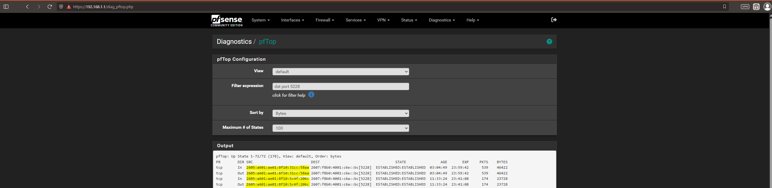

  • Is there a way to change pftop width in the GUI?
    792 Views
    Unlikely. The traffic handling for CP clients is identical in Plus.
