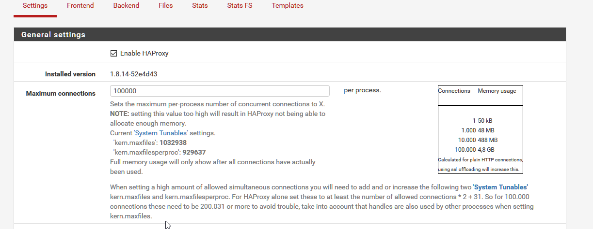

    @piba said in Proxy HA slow redirect https to http - [ miragration vm with different subnet ]: haproxy upgrade from 1.8.13 to 1.8.14. @PiBa According to Pieter response, the case was resolved after the haproxy upgrade from 1.8.13 to 1.8.14.
