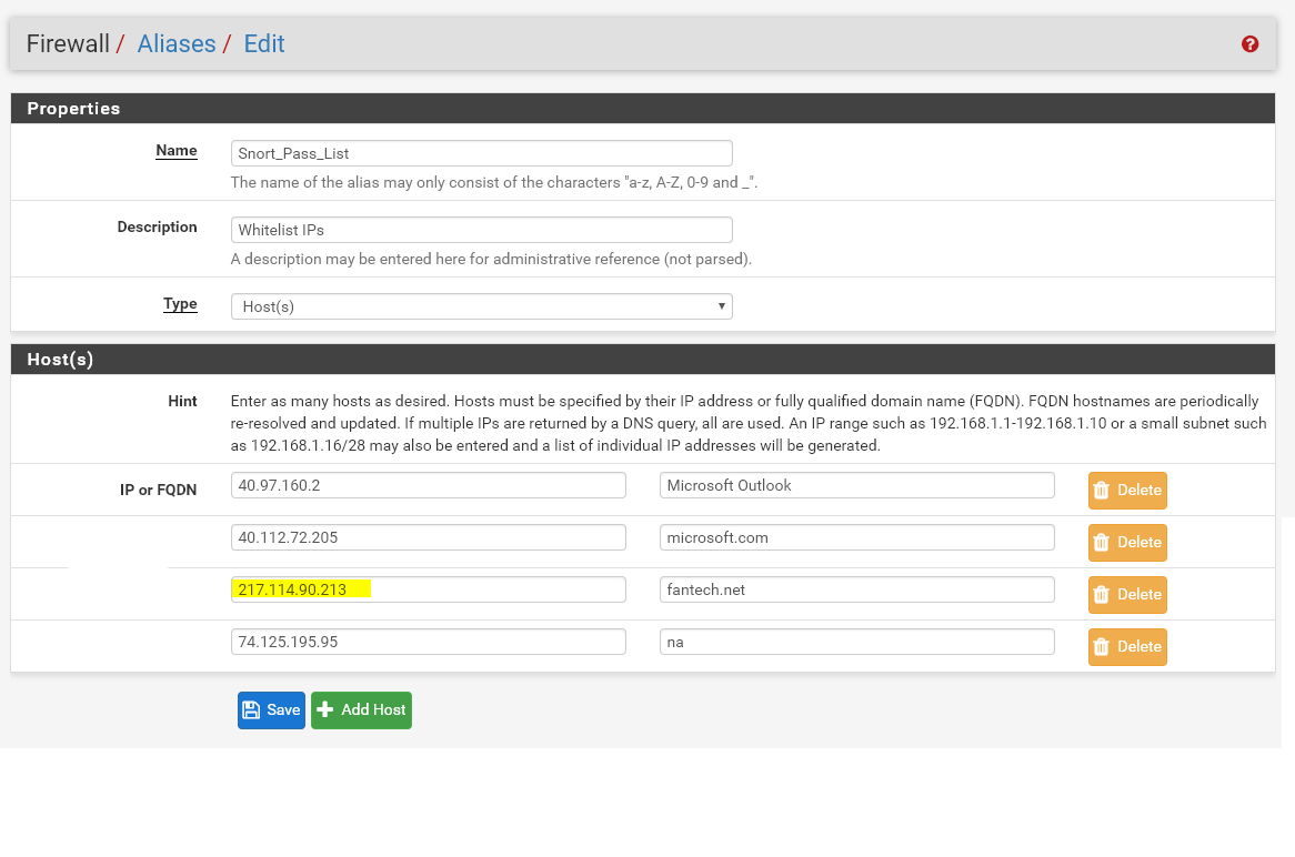

  • Snort ignoring pass lists
    bmeeksB
    @harmisist said in Snort ignoring pass lists: I fixed the pass list on both interfaces. I do have several incoming services, so I need both. When I set Snort up several months ago I followed this KB article which shows them adding the pass list to the external interface. It seems to be working now, thanks for the reply. That should fix it for you, but DO NOT confuse the EXTERNAL_NET variable with the physical external interface (WAN, in your case). They are not the same thing at all. While it is true that most of the !HOME_NET addresses will come into your network via the WAN, that does not mean when you see EXTERNAL_NET to think that only applies to your physical WAN. Go read some of those Google tutorials I mentioned in my first post and learn what those two variables really mean within Snort. I don't mean to sound rude or patronizing with this statement, but your first action that caused your initial issue, and then your second reply to my post about the solution, leads me to believe you do not understand how Snort should be configured yet. Reading some of those tutorials will help you grasp the key concepts.

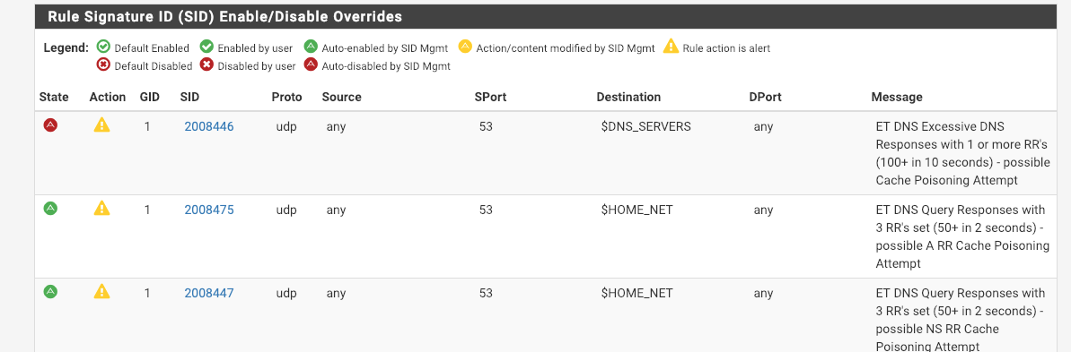

  • Suricata fails to start after pfSense reboot
    18
    18 Posts
    K
    @bmeeks said in Suricata fails to start after pfSense reboot: @kiekar Start with these two Sticky Posts here in the IDS/IPS sub-forum. How Automatic SID Management and User Rule Overrides Work in Snort and Suricata About the New Block-on-Drops-Only Option in Suricata To get some examples of SID MGMT, go to the SID MGMT tab and click the "enable" checkbox. That will populate the page with content. Open any of the example files and you will find comments inside each that explain the options. The internal syntax is copied from PulledPork, so you can Google the PulledPork utility used with Snort to get some examples of what you can do with the enablesid.conf, disablesid.conf and dropsid.conf files. Great, thanks so much. You've been a great help
