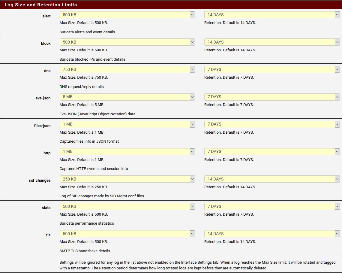

    @teamits Yes, log rotation is independent of the Directory Size Limit setting. The Directory Size Limit is a safety valve designed to prevent firewall DOS caused by running the system out of disk space due to growth of IDS/IPS logs. So if the Directory Size Limit value is reached, and the setting is Enabled, then logs are cleaned up until space drops down below the limit. Log Rotation is a slightly different animal. When Log Rotation is enabled, every 5 minutes a cron task executes that examines the configured log files to see if they have reached the rotation size limit. If reached, that log file is rotated. At the end of the log rotation script it checkes the ages of rotated logs and removes those older than the configured retention interval. So you can enable Directory Size Limit protection and leave Log Rotation and Aging disabled; or you can disable Directory Size Limit protection but enabled Log Rotation and Aging.
