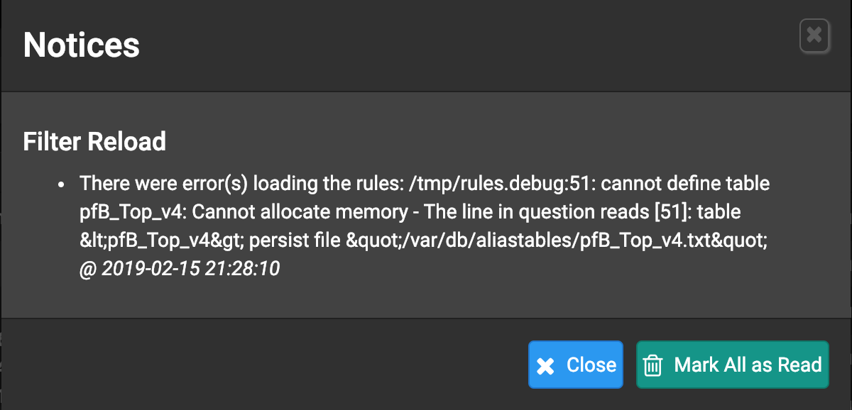

  • pfBlockerNG v2.1.4_16 pfB_Top_v4 block count = 0?
    306 Views
    OK Fixed the error on block count =0 It turns out table usage counts were greater than Table Entries Hard Limit. Hard limit was defaulted to 400000, and lists were slightly greater than that. Increased to 600000, and seems we are ok now.
