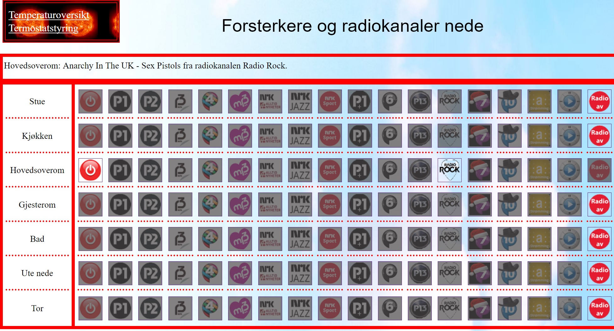

                                    • M
                                      Mastiff
                                      Well, it was mostly the ports on the public side. And no, I can't use one address simply because it's to confusing. Three different zones in the house, and rental guests use one or the other, never the third, and never both the two first. ;) But I am going to work on my freakshow next week and see if I can get HA Proxy to work the way I'd like. I never give up until it's proven impossible. Oh, this is what my web radio page looks like. Pressing any button means that you start playing that radio channel in that zone, and the zones only have speakers, nothing more. Amps are all in the technical room. It's possible to use AirPlay and Bluetooth streaming on the same system, that's in another page. I can't really imagine how to make it more selfexplanatory. On a phone or another screen that can't show everything at once you scroll to the right, and the first column (were the room names are) follows.
                                      • M
                                        Mastiff
                                        Today I had time to mess around with this, and it worked better than I thought it would. I have now converted the webhops to regular hosts, and I don't have to mess with ports at all. I have split the DynDNS hosts into auto.com/auto2.com, anotheraddress.com/anotheraddress2.com and so on. The first is always EventGhost, and 2 is always Girder. From both outside and inside this goes to the frontend of HA proxy on my pfSense box, 192.68.1.1 (from the inside I think it's going directly, but I haven't yet pulled the plug on the Internet connection to verify that). There the pages are split according to name (host matches auto.com and so on), into one of six pfSense VM's with one NIC in (from the 1.1 pfSense) and one pure host NIC (VMWare's virtual network cards that don't need a physical card) to 192.168.1.50-56, which has the internal networks 192.168.3.x-8.x
                                        These virtual NICs are also connected to the automation VM, so it has now 8 NICs (the two physical for contact with the hardware, and those to the VM pfSense). Only the VM pfSenses mess with ports, converting 80 to the necessary port for the webserver instances that are running inside.
                                        This actually works perfectly, with much faster response than before, when I had it hairpin through one M0n0wall and one Asus router.
                                        Dirty? Probably. Working? Indeed. I'm satisfied. ;)
