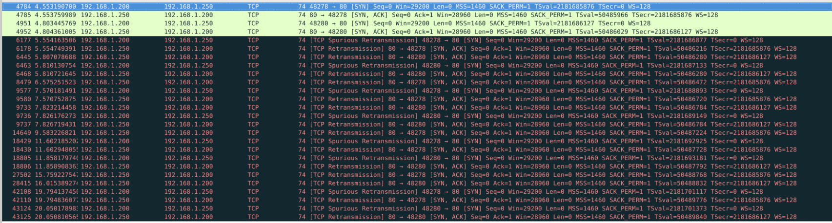

                          I tried capturing packet from a client in the same subnet as pfsense and this is what is happening:
                          i don't really understand what is going on.
                          As for the MAC address, it's going to the correct interface.
                            192.168.1.250 talking to 192.168.1.200 would have ZERO to do with pfsense and or port forwarding at all.
                            Unless you have some really small network mask setup and those are different networks.. But /24 those are the same network and that traffic would have zero to do with pfsense.

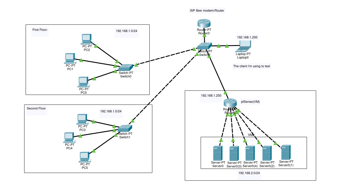

                              192.168.1.250 is actually the pfsense VM ip, in fact the server is under the 192.168.2.0/24 subnet(it's small because i'll never surpass the 40VMs) that is managed by pfsense. 192.168.1.200 is just a client i'm using to test this.
                                well looks like you got some problem with your VM network then.. You mean that was your VM host IP, or pfsense actual IP on the 192.168.1/24
                                Why don't you actually draw up how you got things connected.. But pfsense is not involved in forwarding that traffic or firewalling it because its not crossing a router.. So the issue is at the network layer/nic not psfsense.

                                    This, is my network, i used only few computer but there are a bit more, the same with the VMs.
                                    to make this work the NAT on the pfsense router should be working but it seems like the packets can't go back to the client.
