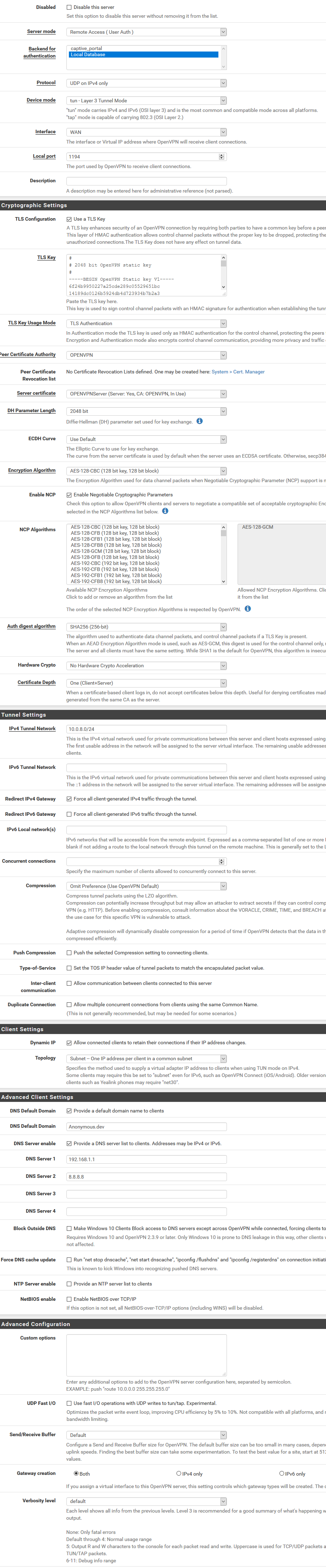

      I am using openvpn enable inter client communication and also used advance config to push static routes and it didin't work still wasn't able to connect to access points. In addition I enabled pushed all generated traffic through the tunnel, which also didn't work.
      Lan ip 192.168.1.1/24
      openVPN tunnel network: 192.168.100.0/24; I have changed this ip multiple times to different classes from A right to C and it still didn't work.
      Pfsense version 2.4.4 64bit
      ---What works--
      I am able to reach the firewall by its lan ip when openVPN enabled.

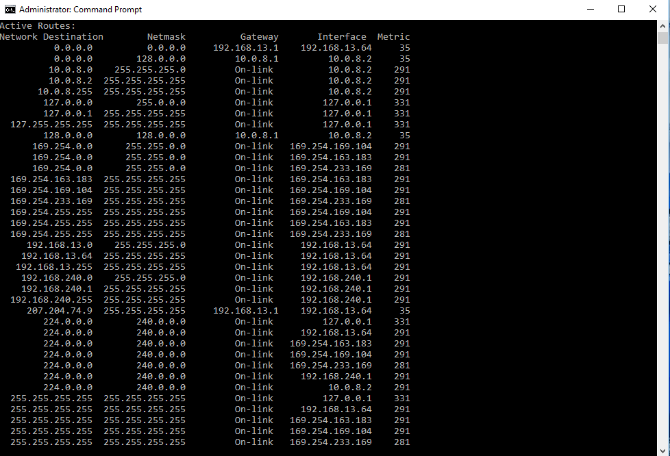

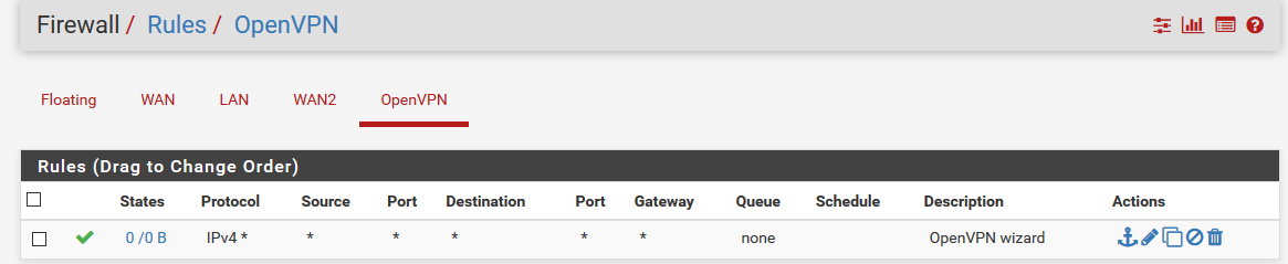

        Can you attach screenshots of
        • OpenVPN server config
        • Firewall Rules for OpenVPN
        • route table from OpenVPN client when it has OpenVPN up
        1 Reply Last reply
        Reply Quote 0
        • T
          tripplex95
          0_1541318488851_Screenshot_2018-11-04 Anonymous Anonymous dev - VPN OpenVPN Servers Edit.png 0_1541318546703_Screenshot_2018-11-04 Anonymous Anonymous dev - Firewall Rules OpenVPN.png 0_1541319399920_routes.png

            I see no traffic on OpenVPN tunnel. Can you try to use Packet Capture (Diagnostics/Packet Capture) to check if there are any incoming packets in tunnel?

                You can reach the LAN address of the firewall from one of the OpenVPN clients?
                Can you show your OpenVPN firewall rules? Set to LAN net and not LAN address right?

                  It's there apart of the screen shot. Look above the cmd route output.
