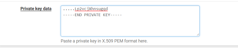

      Adding an extra line at the end of: "-----END PRIVATE KEY-----" in the "Private key data" section seems to have fixed this issue and it is properly formatted during a service restart.

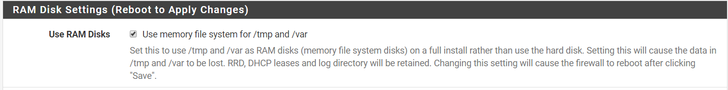

                It starts up fine after a reboot here. Do you maybe have /var/ and /tmp/ in RAM disks?
                Yes, I have this enabled in pfSense:
                  That is what is causing it to be removed every reboot, not the package.
                  I made the package re-create the dirs on each sync now though so it should be fine.
                  Do not Chat/PM for help!
