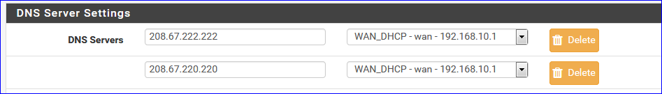

        Anyway. I have an account with OpenDNS, so I :
        1. Stopped using the Resolver which I use normally (for DNSSEC etc).
        2. Entered these on the System => General Set up page :
        1. Activated the Forwarder.
        And done. This URL https://support.opendns.com/hc/en-us/articles/227986567-How-to-test-for-successful-OpenDNS-configuration- confimed that my request went through OpenDNS.
        Pffff. Took me 60 seconds flat.

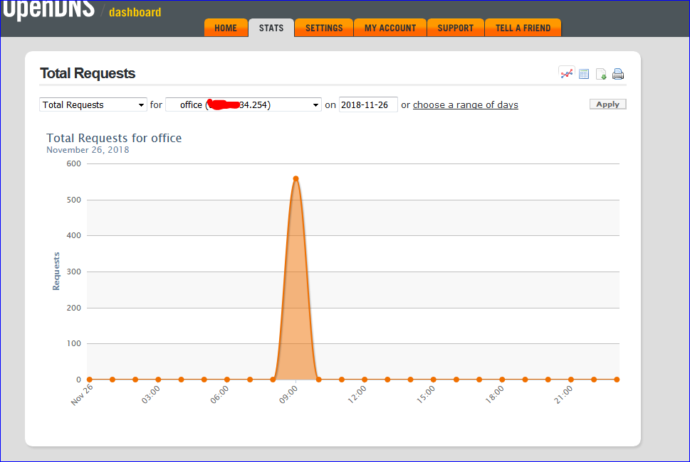

        Another proof that it works :
        edit 2 : another proof : it's 09h00, monday morning. My colleges are showing up.
        Took them less then a minute to find out that their favorite p0rn sites are not reachable anymore ..... I promised that I 'have a look at the situation" ^^
