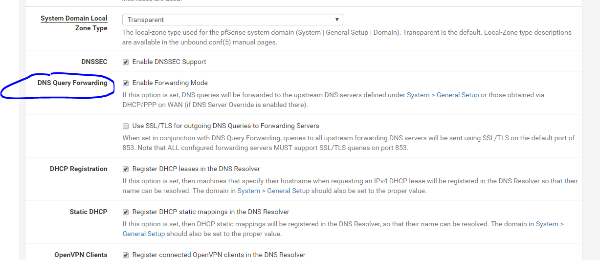

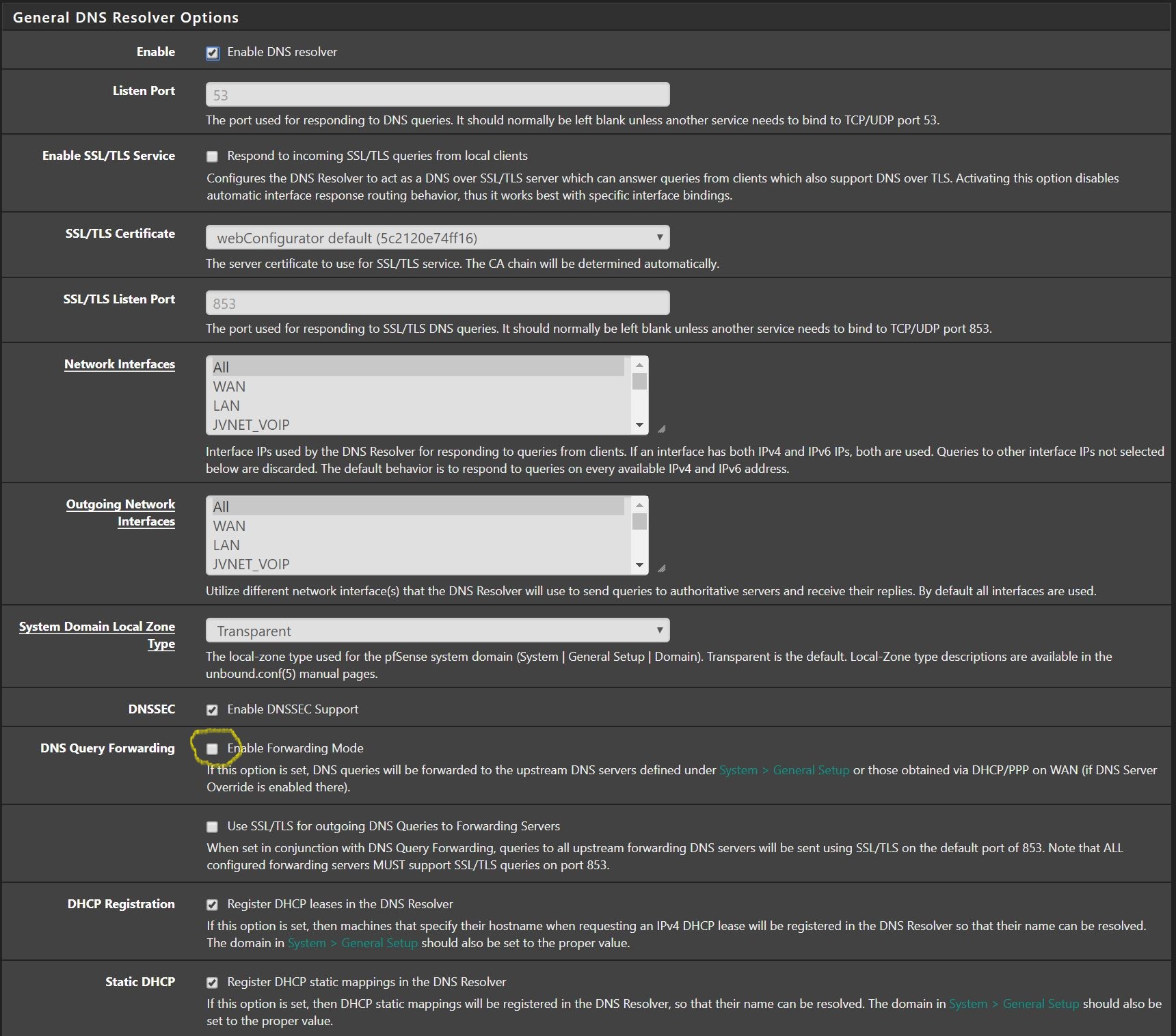

              Okay this DNS is still not working for me. If I turn off DNS Query Forwarding I get name resolution but it won't see anything my local DNS server has. If I turn it on I get what the pfSense knows about but nothing else at all. Wont even find google.com. I have attached my general page which shows the IP I want it to query and the DNS Resolver setup.
              I have tried turning off/on the DNSSEC. No difference. Forwarding mode should use the IP in the General page but doesn't. I can ping the IP from pfSense so it is visible and there are no LAN rules that should be blocking it. Only extra running is pfBlockerNG.

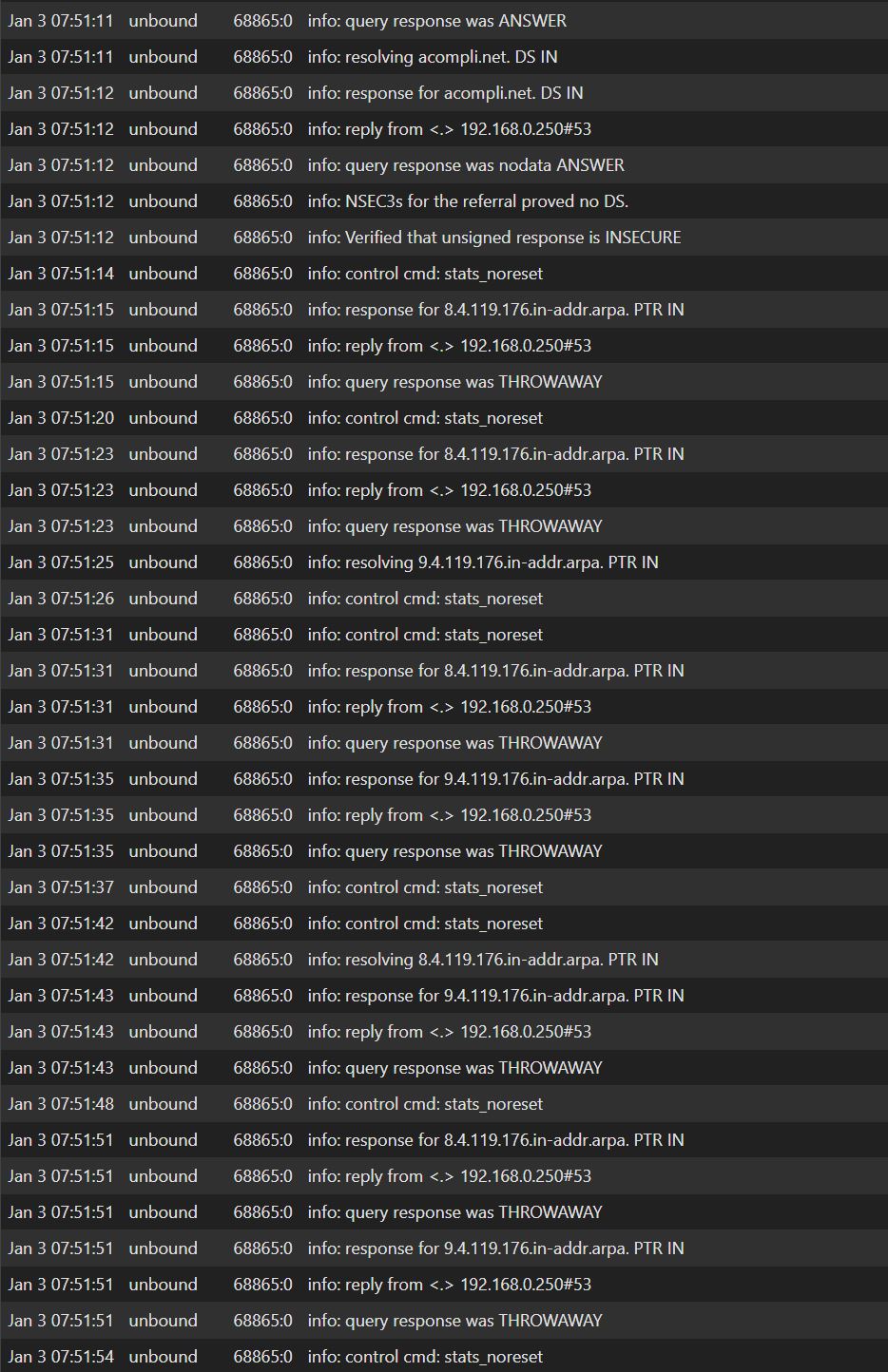

                  Yes, I have internal servers that have internal names (Windows Server 2016) and using external DNS means these names are not found. Under my Unifi I had the DNS look at my internal DNS server and if that could not find it then it would forward out to to the internet. I can't see why pfSense can't do the same as I have told it what IP to forwad requests to that it can't serve. I checked the log file for the Resolver and it looks to me like it is trying but not working. Never used ubound before so is all new to me.
