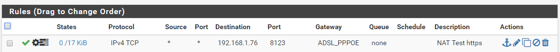

      WANPPP rules:
      The reply-to option is enabled globally and on the rule (disable is not selected).
      In the firewall log I see the traffic is passing, but when doing a packet capture, on the LAN interface I see the request and response, but on the WANPPP interface I only see the requests but not response.
