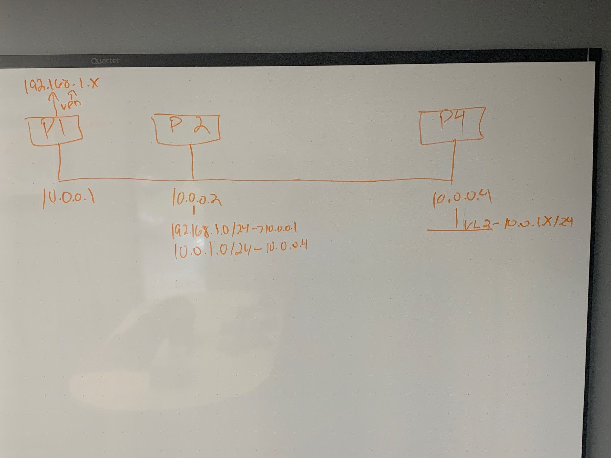

@Derelict It's just basic routing. But something is blocking traffic somewhere and i can't see it or i'm missing it.

from the VPN side I can't get tcp packets in but ICMP works. Smells like a firewall rule but I have a allow ip any any rule to prevent that. I'll try and get a basic drawing for you.

I have a computer using 10.0.0.2 as it's default gateway.
and a computer on 192.168.1.x vpn.
The computer using 10.0.0.2 as a gateway can get to the computer on 192.168.1.0
The computer on the vpn can not get back to the computer using 10.0.0.2.
But they can ping each other.
P2 has the simple default routes, but its like the route isn't obey'ed or it's trying to nat the traffic?

A -> B -> C -> E - Traffic From Remote Location
E -> D -> C -> B -> A Traffic Going Back
A = Remote Server
B = Remote Cisco Router
C = PFSense Router 1
D = PFSense Router 2
E = Local ServerVPN Tunnel between B and C
E = Has services hosted via the wan connection on D, but needs to talk to a server over the VPN TunnelWhere would you put a transit network. That seems like it would complicate a rather simple configuration?
It's not simple. It's asymmetric. It breaks TCP through stateful firewalls as you have found out.
I can't make anything out of that "diagram". I'll need more detail. Like interface addresses, subnets, etc.
