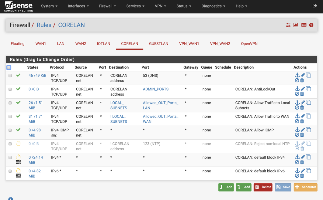

      1. VLAN firewall rules are these:
      CORELAN:

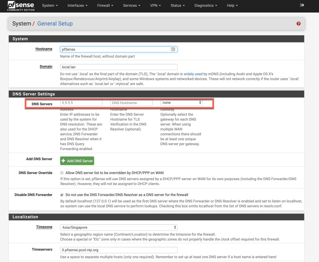

      1. Cloudflare is set up as the DNS in the 'General' screen.

        Are you running the nslookup command from a Windows PC? If so, your problem is that PC has it's DNS server set to 192.168.50.1. That is not your Pi-Hole server, but instead appears to be the LAN interface of your pfSense box. Your firewall rules on the LAN interface are not redirecting all of your DNS traffic. The third rule in your screenshot of the LAN interface is only going to "catch" traffic that has a destination of 192.168.1.100, but your client (the one in your nslookup screenshot) is not using 192.168.1.100 for its DNS server. It is using 192.168.50.1, so since the destination IP does not match neither does the rule. You need to get that DNS server setting on the client figured out and fixed. Your client will need to use 192.168.1.100, or else you need to change that LAN rule to SRC = any, SRC PORT = any, DST = any and DST PORT = 53.

              In your case I see that you have Pi-Hole setup on your 192.168.100.x LAN subnet. Make sure you have added the necessary firewall rules to your other VLAN subnets to allow clients on those to send DNS requests to Pi-Hole, and then change the DHCP information on the VLAN subnets to make sure that Pi-Hole is assigned as the DNS server to clients. In Pi-Hole itself use the pfSense LAN IP as the upstream DNS server for Pi-Hole to talk to. Inside pfSense, decide if you want to run Unbound as a DNS Resolver or DNS Forwarder. If Resolver, there is no need to enter any additional DNS servers under General --> DNS Settings because pfSense will always resolve (i.e. talk to the DNS root servers first) if the DNS information is not available in the cache. If you are running Unbound in forwarding mode, you can enter your forwarding DNS servers in General --> DNS Settings.
              Also, regarding NAT redirects: Right now I see that you have only have one NAT redirect rule on your LAN subnet. I don't think this will rule will do anything since any traffic originating on the LAN subnet 192.168.1.x bound for 192.168.1.100 (also LAN subnet) will not need to cross (i.e. talk to) the firewall. I think what you actually want is NAT redirect rules for each of your other VLAN subnets to ensure that if DNS traffic (originating from them) is not bound to Pi-Hole it gets automatically redirected to Pi-Hole.
