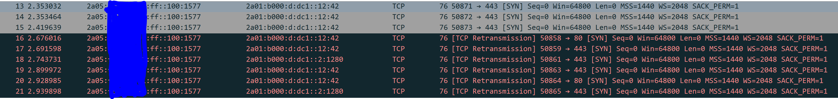

                                Cathal1201 @JKnott
                                @JKnott @pfadmin
                                Two small lines, but the first isn't working
                                A packet trace shows that I have many retransmissions on OPT1
                                Does it point to the VPN provider, that I can't route?
                                I'm really at a dead end and way over my abilities โ˜บ

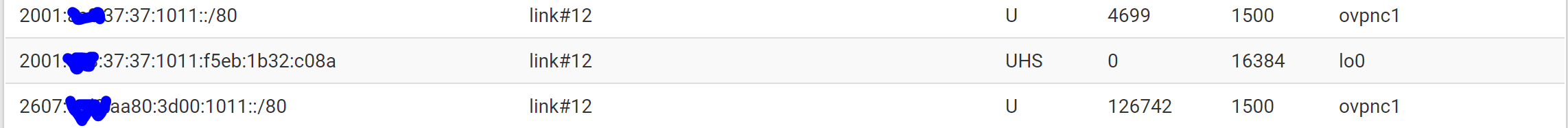

                                      And everything looks good, I don't see why I should use Local-Link address instead?
                                      From my desktop, I can ping the interface OPT1, but not the OPT1_VPNV6 address. That points to at routing problem for sure, but the routing table is confusing to me.
