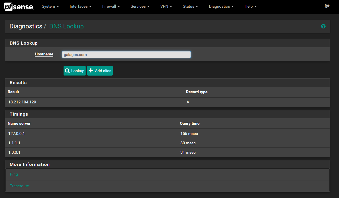

      This just started a week or two ago, and I've exhausted my troubleshooting knowledge. It's gotten noticeable on the network, and I'm curious what I may be missing.
      I'm seeing 140ms to 300ms responses to DNS queries locally, while I get low latency responses from my upstream name servers (Cloudflare).

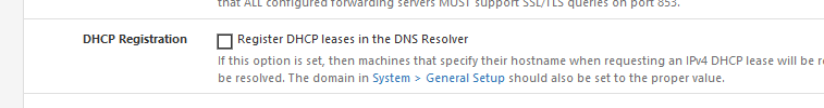

                  Two things cause a bunch of unbound restarts: installing pfBlockerNG-devel and using the DNSBL functionality; and having automatic DNS registration enabled for the DHCP server. My first suspect is the latter.
                  You need to turn that option off if it is enabled. You will find it under the DHCP Server settings. When that option is enabled, the DHCP service will restart unbound every time a client's DHCP lease is renewed. This is exacerbated when the client DHCP lease time is very short.

                      @Gertjan Thanks! The restarts have all but ceased now after making the changes you & @bmeeks recommended. I also enabled Query Name Minimization (not strict). So far, things seem to be a bit better.
                      I don't know if I'm sold on disabling the DHCP leases because I do like to have the local name resolution on-network. I'll look in to other alternatives.
