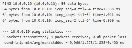

            An interesting thing i found is that the device doesn't always appears in the arp table. I just checked and the ip 10.0.0.10 is not there and neither is the device's MAC address. however, pfsense can ping 10.0.0.10 without a problem.

                          But, the device was not reachable when i tried to ping 10.0.0.10.
