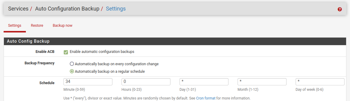

Yes, if you're seeing that try setting the backup time to something other than one the hour. Off set by 5mins for example. We introduced a random time factor into new configs but a lot of users are still using the hour exactly for scheduled backups and that presents a large peak load.
@stephenw10 said in Auto configuration backup shows no backups:
Thanks Steve, but the UI for 2.5.1 only shows Hours, Days, Months & Weeks, and doesn't include Minutes as an option, that might be why all the backups are being run on the hour :)
Actually, I've just tried to set the hour to 4 and clicked save, go out and back in and it's reverting to 1 again.
Hmm, you're right it does seem to revert to hour 0 for me. However the actual cronjob remains correct.
If you install the Cron package you can see that and you can also set a minutes value there to offset it. That will revert if you resave the ACB settings but you should not need to do that.Steve
Ah that's a known issue that's fixed in 2.5.2:
https://redmine.pfsense.org/issues/11946Steve
