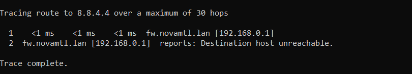

      Hey all, just upgraded to 22.05 on my Netgate 2100 MAX, rebooted and now no internet for the office.
      I am new to pfsense, so i am not sure what to look for?
      Not sure what to check as all looks well? Cannot ping by ip or name, tried pfsense ping , can reach anything.
      Any ideas? Lots of upset office workers over here.
      I did check if a weird gateway was on the LAN interface, but its blank.
      Anything else?
      Thanks!

                              SteveITS Rebel Alliance @robmontreal
                              @robmontreal said in Just upgraded from 22.01 to 22.05 on my Netgate 2100 MAX, cant reach internet now?:
                              You rebooted or it rebooted itself? Upgrades will reboot automatically but it can take 10+ minutes sometimes, just wait it out.
                              tried pfsense ping
                              You can't ping the pfSense or the pfSense can't ping out to the Internet?
                              LAN should not have a gateway, only WAN.
                              192.168.1.69
                              2001:56a:f1e1:c500:92ec:77ff:fe20:724
                              The IPv4 is a private IP, do you have another router in front of your pfSense? Can you ping that router?
                              Can you ping using IPv6? In Windows:
                              ping -6 ipv6.google.com
                              or
                              ping -6 2607:f8b0:4009:81b::200e

                                    robmontreal @SteveITS
                                    @steveits
                                    Ok i plugged modem back into netgate, i have a gateway under wan, but i cannot ping it, using ping under diags menu
                                    Under status>gateways it says Pending everywhere?? Is this normal?
                                    Thanks
                                      robmontreal @robmontreal
                                        @robmontreal The pending status is probably because it can't ping the gateway either (?). In System/Routing you can edit the gateway and check "Disable Gateway Monitoring" but that's a bit of a hack. Does the ISP router normally respond to pings?
                                        Is your WAN DHCP?
                                        Upvote 👍 helpful posts!
                                          @steveits Hey Steve, i do not think my isp router normally responds to ping, i would have to reconnect the old router to check as everything works with old router.
                                          My WAN is DHCP.
                                          The pending was because i had the wan disconnected, my bad... it shows good now....
                                          Can i provide more screen shots for you?
                                          Thanks..
                                            @robmontreal OK so that's a public IP at least. If you can't ping the .1 gateway then either that gateway doesn't respond to pings, or there's some weird routing going on, or there's a firewall rule blocking your ping, etc. That shot shows the gateway online though so it seems like the monitoring did ping it...
                                            Is anything set in System/Routing/Static Routes?
