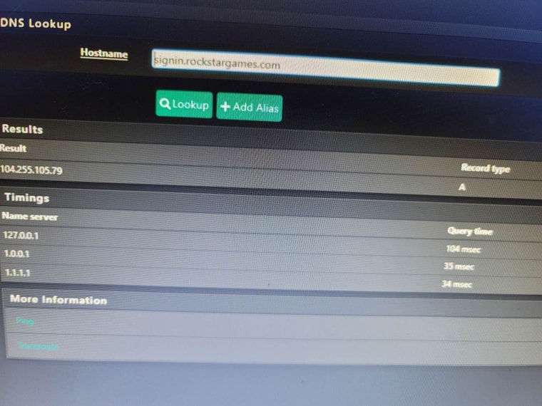

                    lawrence1986 @rcoleman-netgate
                    @rcoleman-netgate sure is.... https://signin.rockstargames.com/connect/authorize/rsg?returnUrl=/&lang=en-us&_gl=1y0fq40_gaMTQ2NTgyMDgzNC4xNjY4MzY2NDQw_ga_PJQ2JYZDQC*MTY2OTU3NDQ1NS41Mi4wLjE2Njk1NzQ0NTUuMC4wLjA.

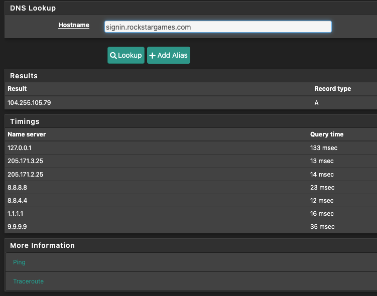

                    • R
                      rcoleman-netgate Netgate @rcoleman-netgate
                      @rcoleman-netgate said in Please Help Me Under Stand! What The Issue IS.:
                      @lawrence1986
                      Go to Diagnostics->DNS Lookup
                      Look for the hostname
                      Post the results here.
                      Like this:

                          rcoleman-netgate Netgate @lawrence1986
                          @lawrence1986 You can't do a DNS request of a web page.
                          Just the hostname -- look at my example.

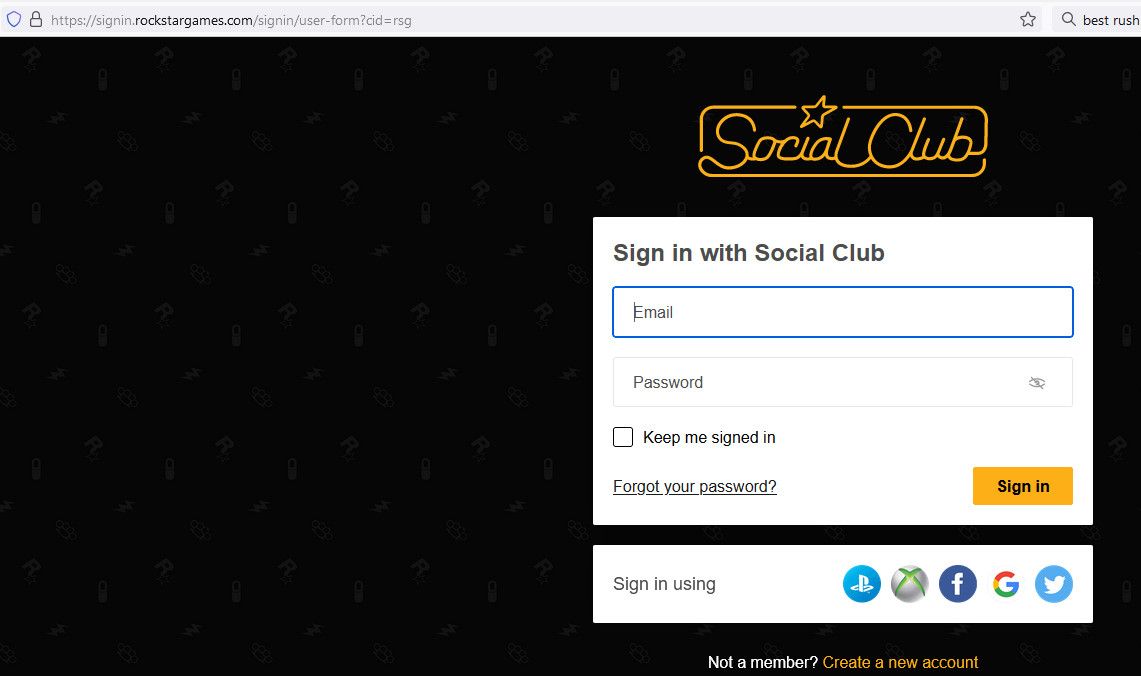

                                    If got to their website, then click the little user icon in the top right I go to the sigin url - and sure seems load.. Your saying you can not do that on most of your machines - but 2 laptops can?

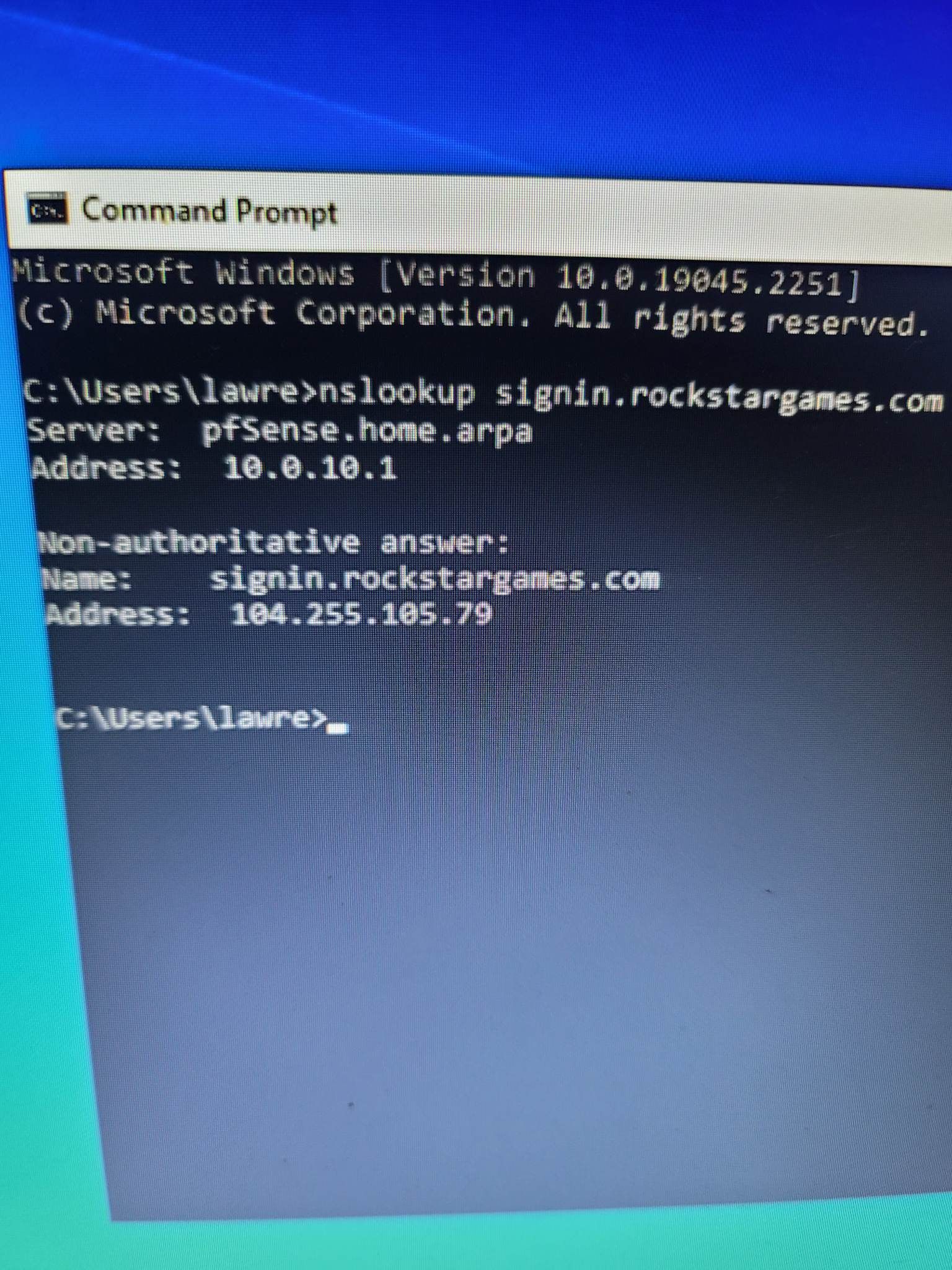

                                        @lawrence1986 Open Command Prompt on any of the PCs that won't resolve the domain and run:
                                        nslookup signin.rockstargames.com
                                        Ryan
