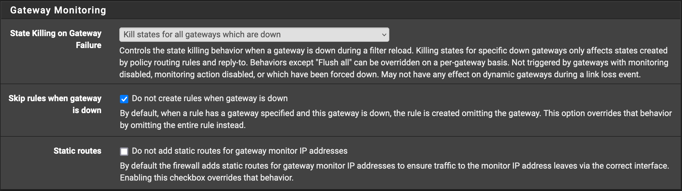

            You have it set to kill all states when gateways fail - so you would have to create a new state to connect to the gui after internet goes down, because all existing states would be killed.. Turn that off.. Or create a new session to connect after your internet goes down.
            Do you have a rule with a gateway in it on your lan side? Your setting there would not create a rule if the gateway is down.. Can you post up your lan side rules please.

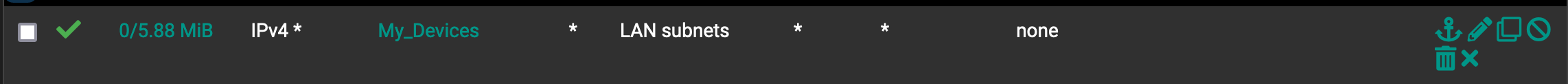

                  I have 3 VLANs and I thought the Anti-Lockout rule on LAN would suffice for all other VLANs as well. Right now I added a new rule on wifi vlan and I can access GUI when both WANs are down (PON Loss)

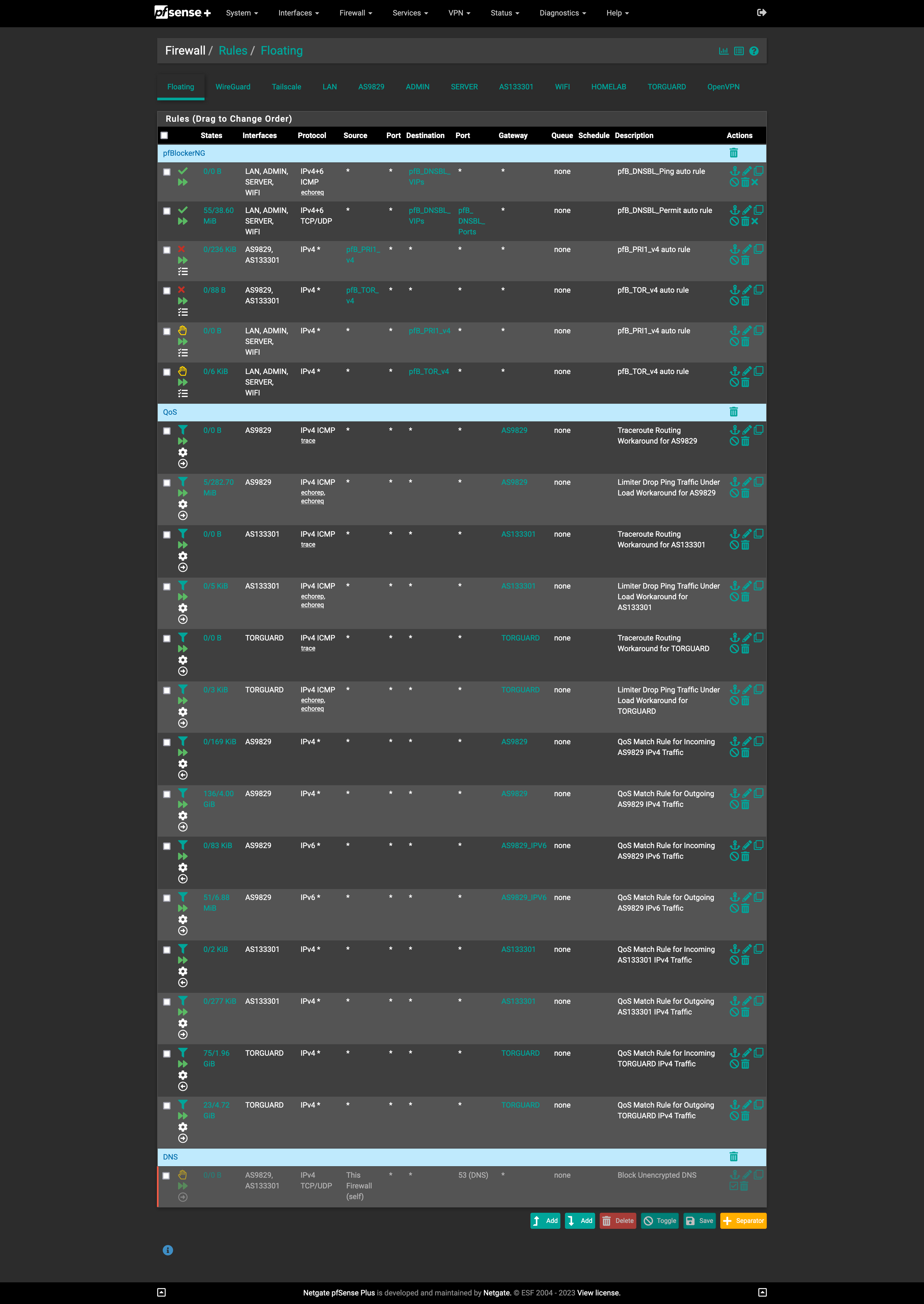

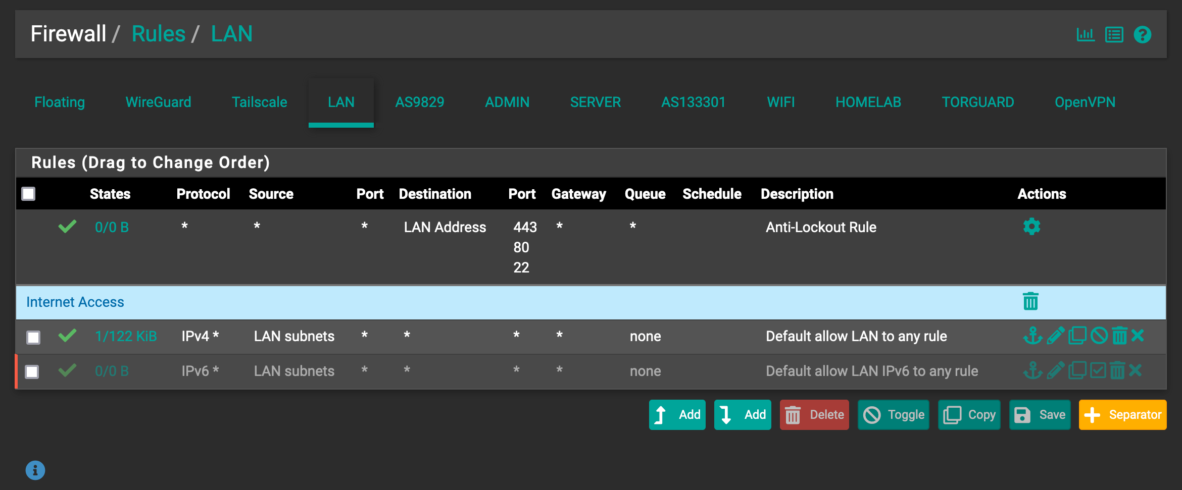

                      @johnpoz Here are all my Firewall Rules.
                      Floating:
                      LAN:

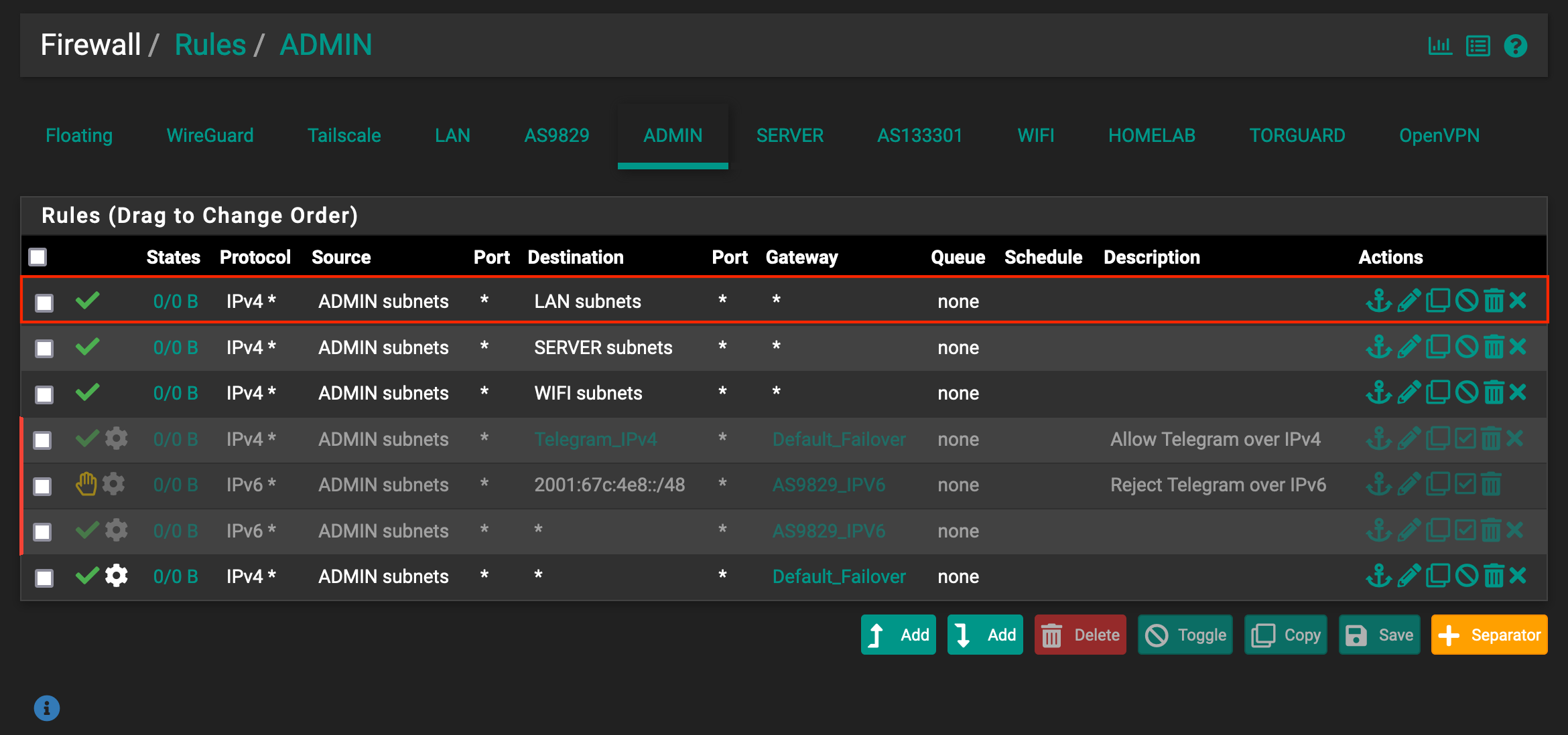

                      VLAN 10 (ADMIN):
                      I had this highlighted rule which explains why I was able to access GUI from this VLAN when both WAN is down.

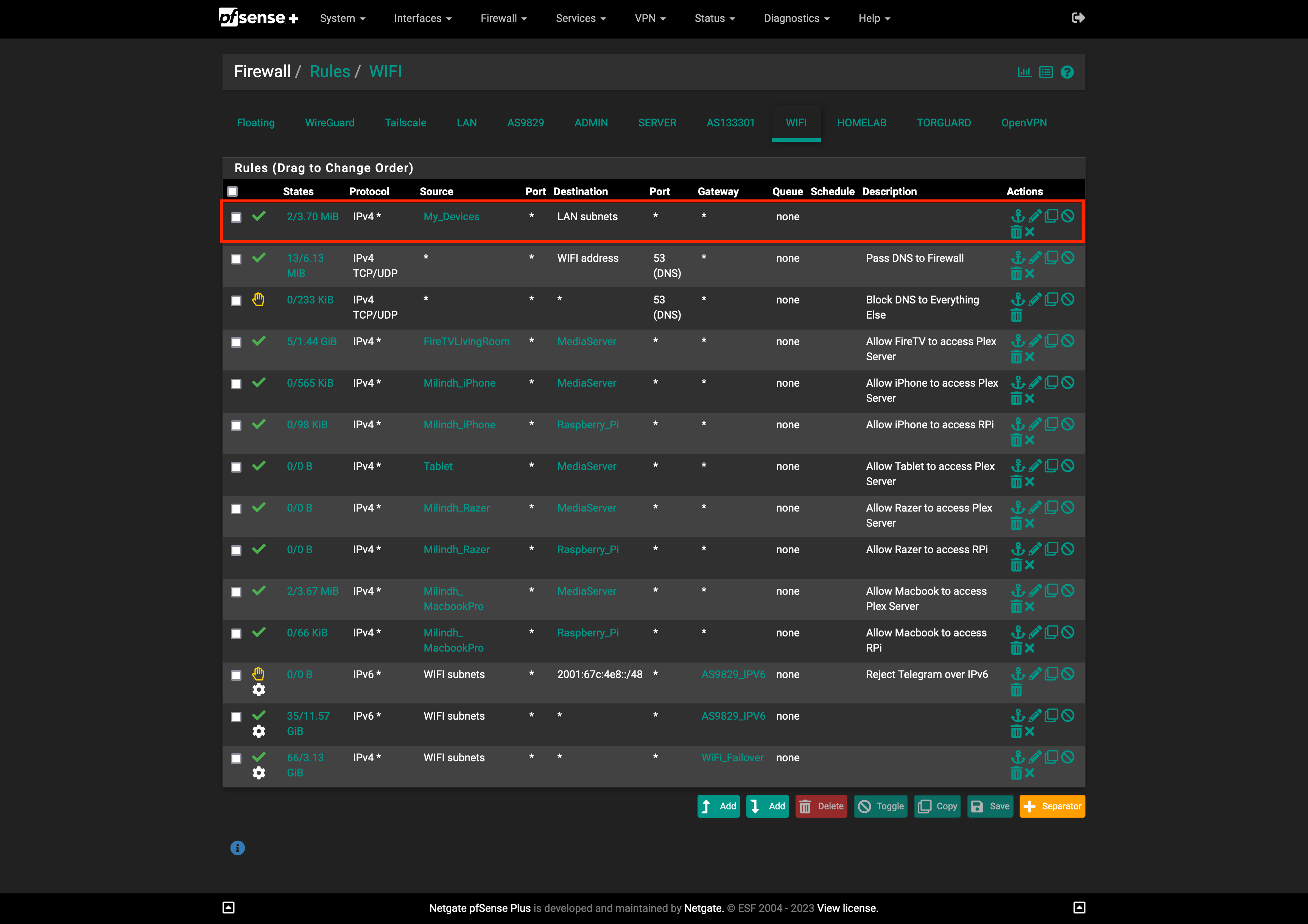

                      VLAN 30 (WiFi):
                      Before adding the highlighted, I could not access GUI when WAN was down.

                        @milindhvijay So like I was say if you have a rule using a gateway, which you have. And you have it set to NOT create rules when gateway is down.. Before you had no rules that would allow access to the IP on your admin vlan.
                        So when your gateway goes down, per your settings that last rule there with the gateway set as "default_failover" would not be there.. So until you added that rule you have highlighted what rule if you remove that last one since you are telling it not to create rules when a gateway is down would of allowed you access to pfsense gui on any IP?
                        If that rule you created is to allow access to web gui, why would you say lan subnets. Why would you not just allow access to the admin interface address?
                        But yeah your rules from before you added completely explains why yes if your wan(s) were down you would not be able to access web gui or even ssh.. Because you had no rules that allowed it when your gateway(s) are down.
