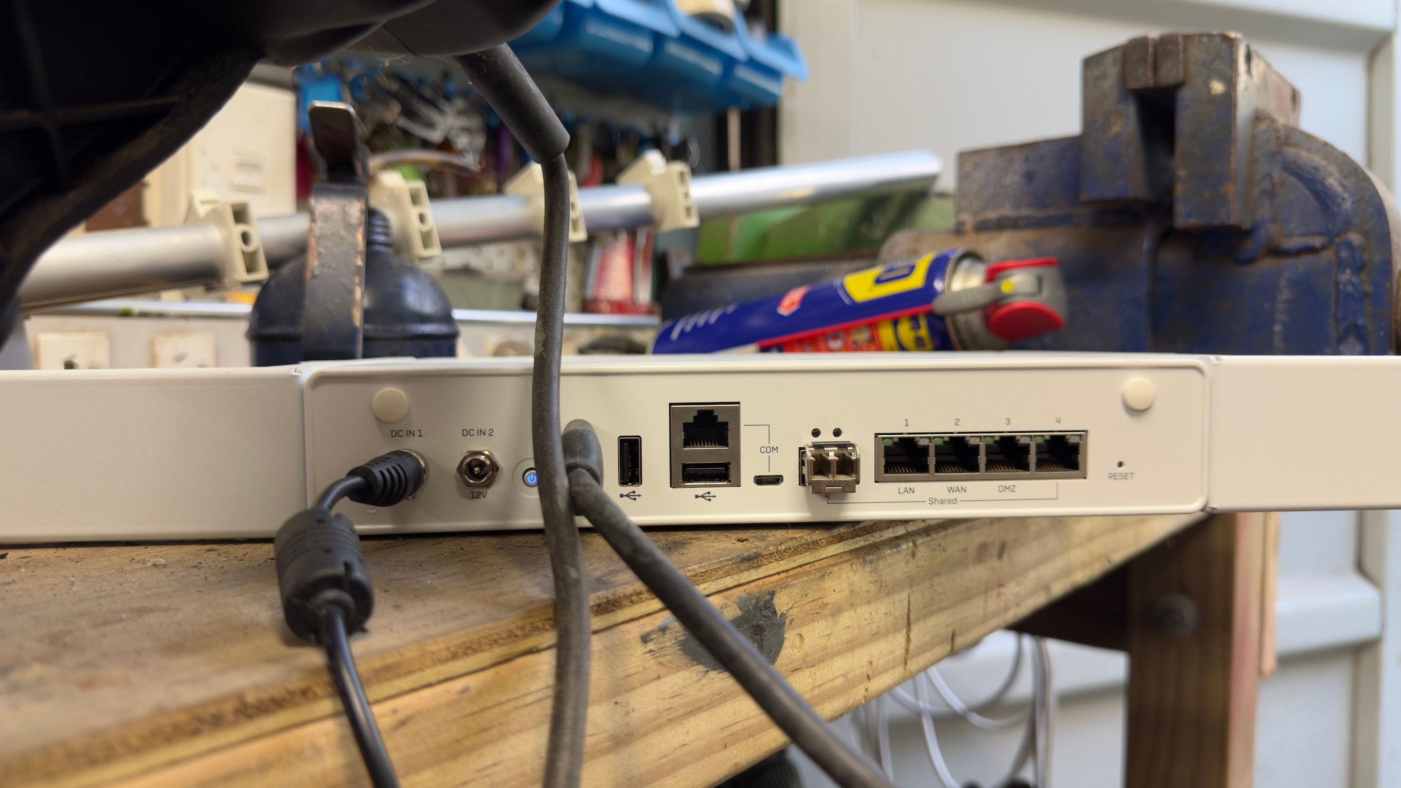

I am having a VERY frustrating issue with pfSense on a Sophos XGS117 hardware. This issue seems to be new as I dont recall having this issue prior to the latest pfSense version.
I'm not sure if this is directly related to pfSense or more a FreeBSD 12 issue, but everytime the firewall is not recoverable and results in the need to completely reinstall. This seems to only be the issue if the power is lost suddenly.

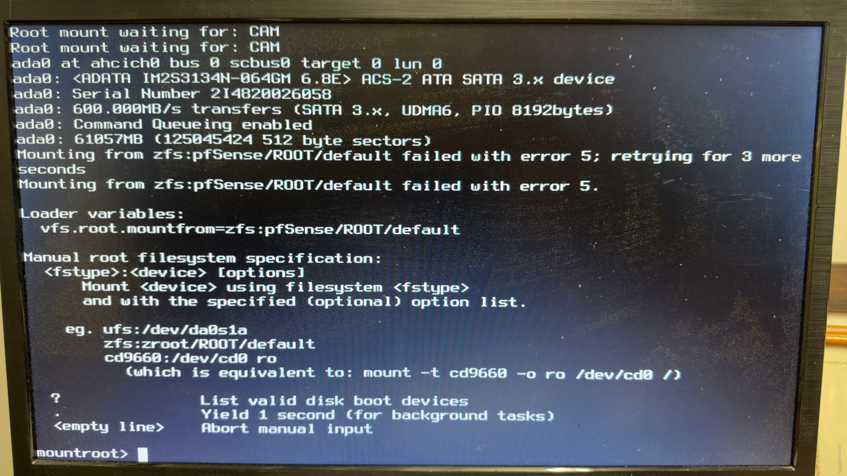

I am using ZFS filesystem.pfSense actually boots, but it then fails to MOUNT the pfSense/default partition? See screenshots below.

Root mount waiting for: CAM (lots)
Then:
Mounting from zfs:Pfsense/ROOT/Default failed with error 5
Error 5, as per screen shots here.Any zpool command gave error
