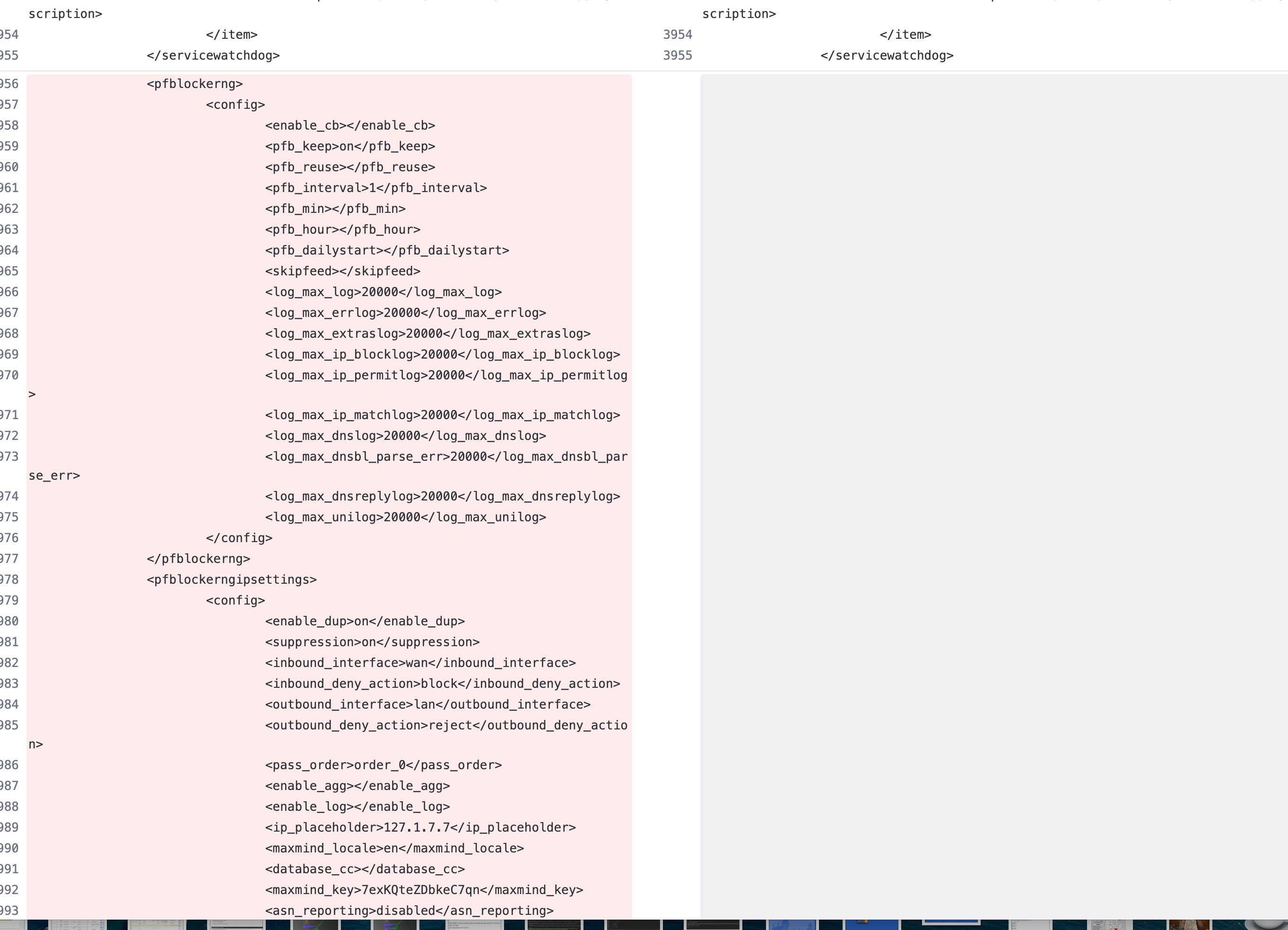

        I installed it it has many settings. keep shows off but on in config.xml I hardset off ran rm /tmp/config.cache and reset and uninstalled. Interesting right? It's gone now. Thanks for reply

          You can just remove all the pfBlocker config if you don't have it installed.
          If you run the setup wizard when it's installed it will add adblocking unless you choose not to.
            jrey @JonathanLee
            @JonathanLee
            Seems possible.
            Based on other posts you've made, in regards to things like shalla list and other items as recently as early November, you have previously had pfblocker installed.
            Then you likely uninstalled it either with or without "keep". This was likely done while pfb was on a version prior to the current one.
            @JonathanLee said in pfblockerng never installed shows in config.xml???:
            If I am reading the post correctly, you installed it today again (right?) and would have got the _7 revision, then you uninstalled with keep turned off.. is that correct?
            the one and only line that change from _6 to _7 has everything to do with the config path being in the wrong format in the older versions...
            -				config_set_path('system','earlyshellcmd',
            +				config_set_path('system/earlyshellcmd',
            you would have had different code ...

                  But your comment on Shalla list wasn't that long ago, in early November, when you commented about a list you use instead as I recall. So the assumption I made was that you simply had used pfb before, and not so long ago. Likely uninstalled it, then reinstalled it today with different code and got different "better" results.

                    @jrey What funny is it listed 10.0.0.1:8081 in the config for it, that is the guest wifi and I didn't have that enabled back then I didn't even have the compex card. Weird
                      That could be the DNSBL webserver IP address and port. By default it's 10.10.10.1 but you can change that.

                        @stephenw10 thanks to explain how that works. I was amazed about how much old items are listed in that config.xml file I never had pfblocker set to save configuration and but in the config.xml it was set to save. When I reinstalled it to remove it it still was set to not safe, I had to manually set to no and it finally removed it.
