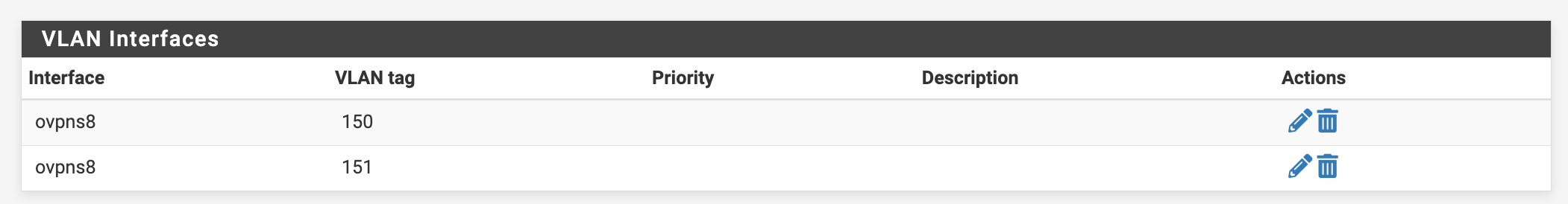

                  I tried to set the VLANs on the OpenVPN tap interface:

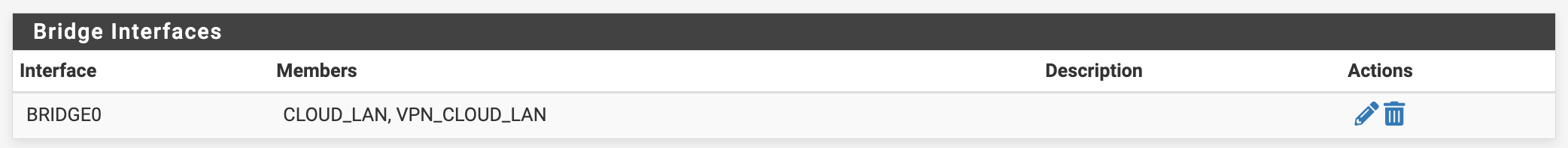

                  And then I added a bridge from the newly created VLAN to the existing interface which is tagged on the switch:

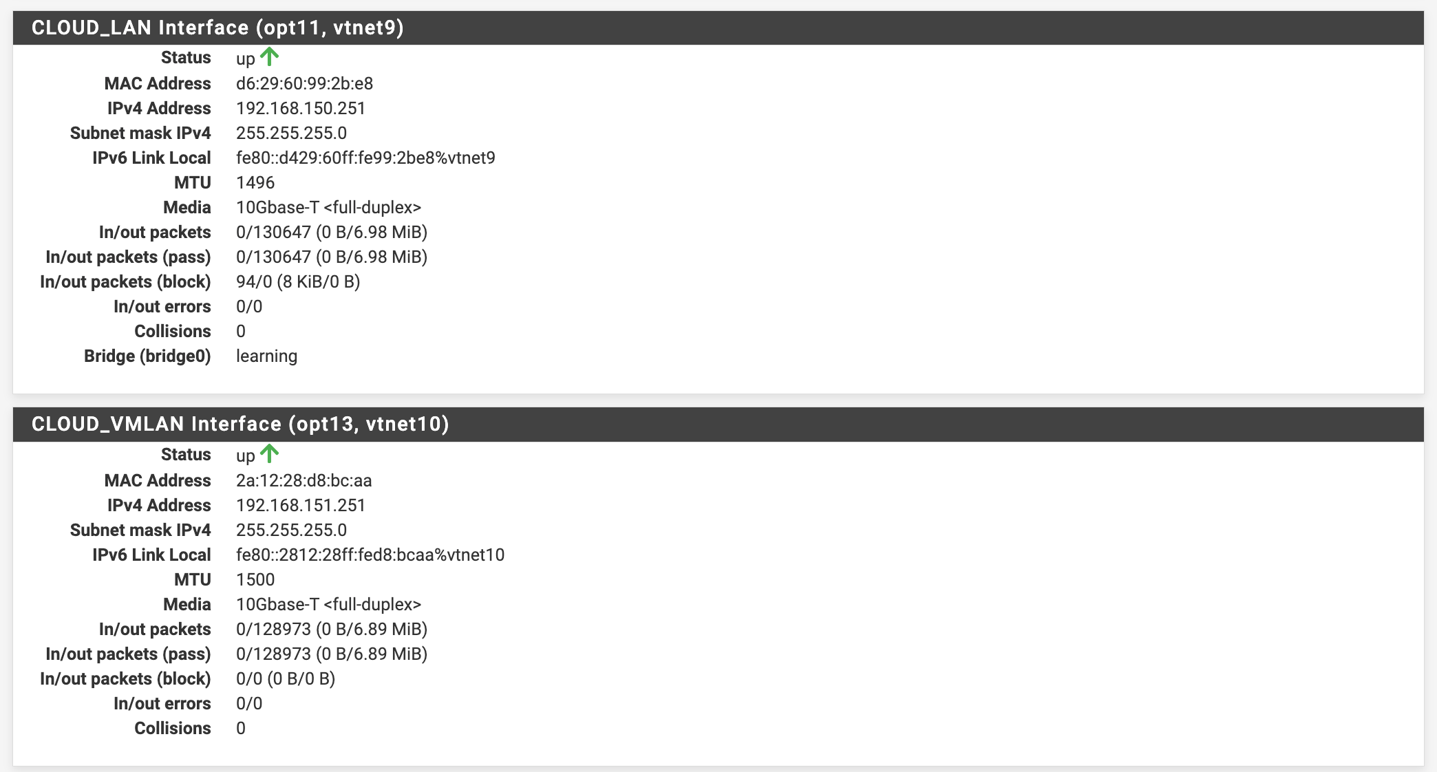

                  The CLOUD_LAN interface has a CARP Virtual IP Address:
