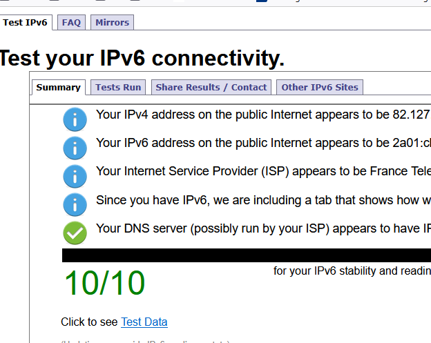

      https://test-ipv6.com/ shows a 10/10 ?

          and the simple IPv6 test :
          My iPhone on the same network also works fine.

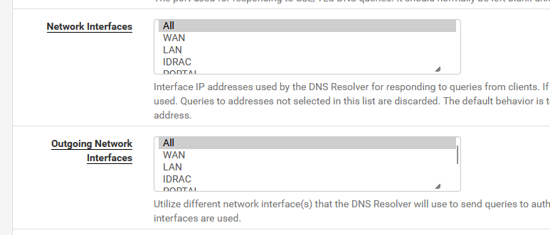

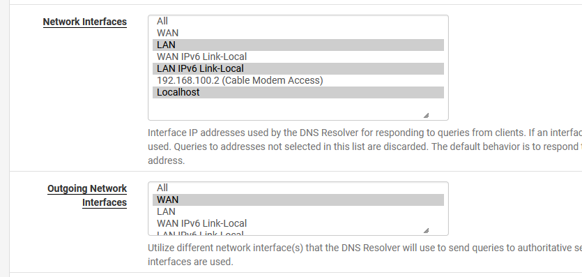

              I think I solved the problem. Previously, in pfSense's DNS server config I had All selected in both Network Interfaces and Outgoing Network Interfaces (the default). I changed this to:
              This caused DNS resolution over IPv6 to start working, in all LAN hosts.

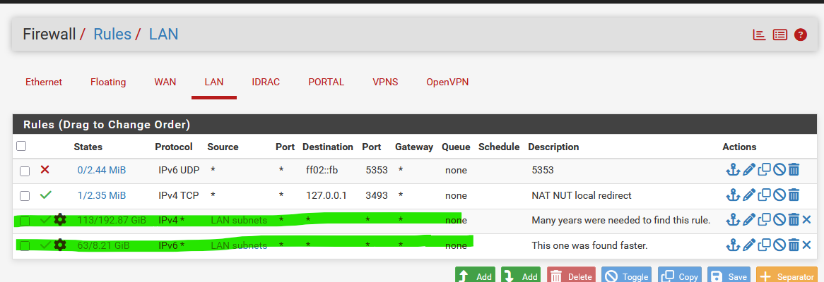

                I use the 'perfect' firewall rules on my LAN :
                These settings, the default settings, should always work :
                I never had to change them.
                The selection you made seem, imho, ok of course.
                Can you confirm that when you switch back to "All" "All" it stops working ?
                J 1 Reply Last reply Mar 28, 2025, 11:07 PM Reply Quote 0

                    @Gertjan I did take your suggestion of switching back to "ALL" outgoing interfaces, and things still work.
                    So I'm going to chalk this up to the DNS resolver getting itself into a funky state over IPv6, which was corrected by restarting the resolver.
                    If this happens again I'll crank up logging to see if anything interesting shows up in the logs.
                    For now the issue is closed.
