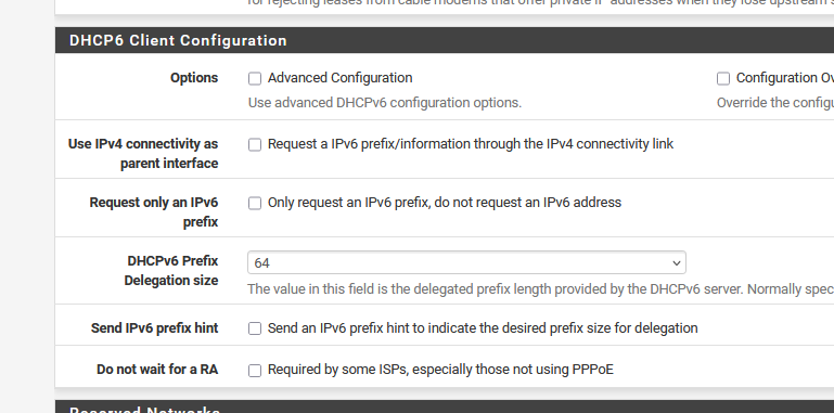

        My WAN DHCP6 settings :
        If I change the /64 for 'something else' everything breaks.
