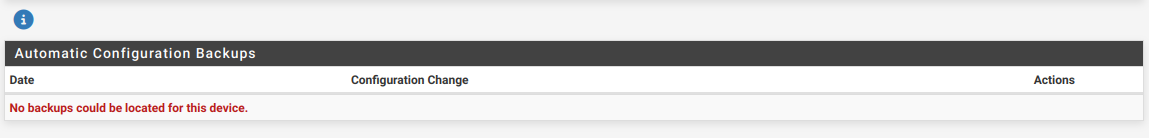

    Re: No backups listed (auto-backup of configuration)
    If so, (when the drive dies it takes the key with it) then only local backups saved are useful if (when) a drive goes south correct?
    I had not thought about that, and stopped taking local backups since setting ACB up. So I'm nearing 5 months out of date.
    eMMC failure on a 4100, added the M.2 NVMe drive. Restored a local backup.
    Am I correct in assuming the visible key is a "new" key ?
    S 1 Reply Last reply May 24, 2025, 12:14 AM Reply Quote 0
    • S
      SteveITS Galactic Empire @mudmanc4
      @mudmanc4 First off, I/we don’t use it.
      You’re supposed to save the key: https://docs.netgate.com/pfsense/en/latest/backup/acb-config.html#device-key
      Check your configuration file to see if it’s in there, probably encoded. I can see reasons why it wouldn’t be, like restoring a backup router.

        Thanks for the reply Steve
        Saving the key is clearly stated, which I did not do.
        I assumed restoring a local backup would have said information.
        However, looking through the config file, I see the password is saved in plain text.
