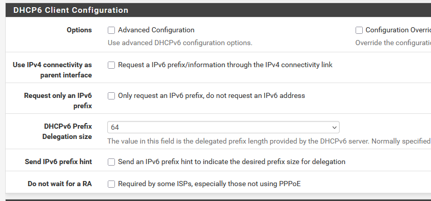

      Have been troubleshooting some ipv6 problems on my pfsense box. I'm a newbie so bear with me.
      Basically I know my prefix and I'm getting it from spectrum but it's not being taken up.
      In the logs I have:
      lstat failed: No such file or directory
      script "/var/etc/dhcp6c_wan_script.sh" cannot be executed safely
      I've been doing some chatgpt troubleshooting - and it suspects that this is the problem:
      dhcp6c refuses to run a helper script unless it is exactly 0700
      And my output is:
      -rwxr-xr-x 1 root wheel 443 Jun 8 21:52 /var/etc/dhcp6c_wan_script.sh
      Is it on the right track, or am I totally off base? Happy to provide more context if helpful. And why would this misconfiguration have occurred? This is mostly a fresh/vanilla install. Thanks!

              @Gertjan Standard file! No special config apart from messing around with the prefix hint. I was a bit nervous to make changes to the dhcp6c service based on chatgpt alone.
              Weird thing - ipv6 started randomly working overnight for about a day yesterday, but is back down this morning, without me doing anything.
