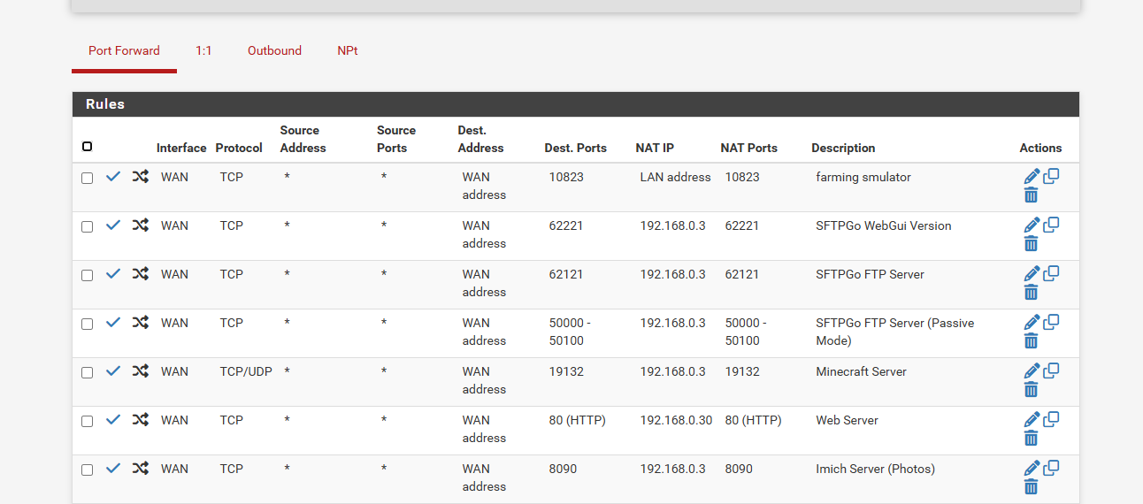

      here is pic of my port forward

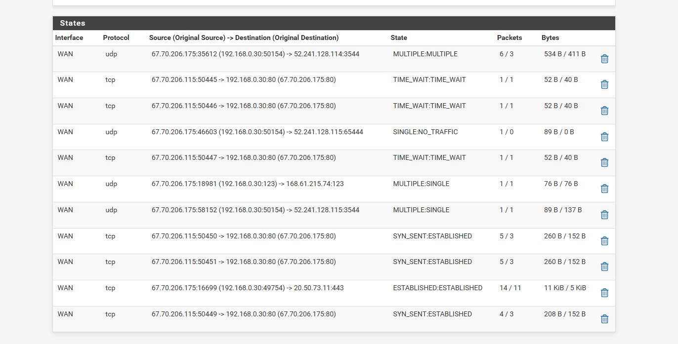

                  comet424 @comet424
                  so i did a ping from the remote computer to the www.example.com the example website
                  it gets ip but the request time out... the states filter shows this if it helps

                    SteveITS Rebel Alliance @comet424
                    @comet424 You will need to forward ICMP to forward pings. I don't know that I've tried to forward ICMP and use reflection on that.
                    Is one of those destinations your remote IP? They look more like outbound connections, at a glance.

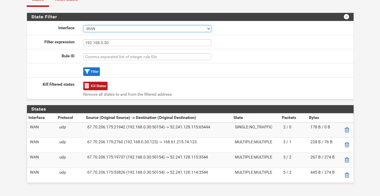

                      comet424 @SteveITS
                      @SteveITS the 67.70.206.175 is the remote computer not connected to pfsense so i pinged on there the webaddress
                      and how do i enable icmp thats for pinging right just the port on port forward? or LAN?
                      and here i did states again and on the remote computer i did the website address in Internet Explorer and got
                      and i did a kill states before i tried webpage...

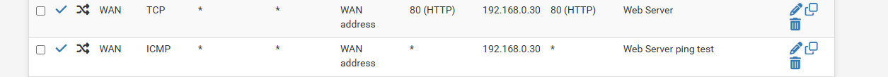

                        comet424 @comet424
                        so i added icmp on the port forward but got request timed out still
                        port forward side
                          stephenw10 Netgate Administrator @comet424
                          @comet424 said in Port Forwarding stopped working after upgrading to 2.8.0:
                          the X.X.206.175 is the remote computer not connected to pfsense
                          Nope that's your external WAN IP address in those states.
                          But in the state table above we can see incoming connections from X.X.206.115 to the WAN address and they are being correctly forwarded to the internal server IP.
                          I assume you have that filtered for WAN only? If you allow all interfaces you should also see a corresponding state on LAN.
                          The state you see on WAN shows traffic both ways BUT only 1 packet so it's probably just being refused.
                            Where exactly are you testing from? How is it connected? It's in the same subnet as your WAN.
                            I can open an http connection to that site and ping it OK from my actual remote location.

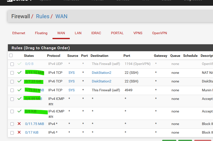

                                        Next step : every NAT rule has a WAN firewall rule - as traffic has to able to get into the WAN interface.
                                        Here are mine :
                                        Observe the States column. When traffic start to enter, the Sates counter start to go up.
                                        If they stay at 0/0 then you'll know the traffic never reaches the pfSense WAN interface, so the issue is upstream.
