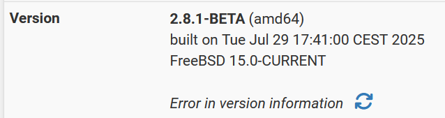

      I've got a bit of a weird issue with updating from the GUI right now. It's not a showstopper, but I'm hoping for some help troubleshooting it because I'm hoping it's not indicative of a bigger issue.

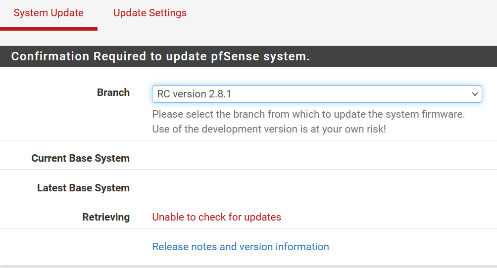

      The machine was running 2.8, I was planning on moving to 2.8.1 BETA for the newer version of Unbound. The GUI shows:
      Moving to the Update screen, I see:
      So I try swapping to the BETA version on the update settings screen, which does nothing to alleviate the problem. I SSH in and hit option 13 so I can see whatever error occurs, but... success! The firewall updates to 2.8.1 BETA and reboots. Logging back into the GUI, the issue still occurs - I'm seeing the "error in version information" and "unable to check for updates." So I go through the Troubleshooting Upgrades docs, up to and including a full reinstall of all packages (this box is on the other side of an ocean from me, so a simple USB stick reinstall isn't going to happen without some heavy lifting). After the full reinstall-and-reboot, which was successful, the issue still occurs - "error in version information"
      Anyone got any clues as to what's wrong? I'm glad I can SSH in and update things, but this is weird. I can't seem to find anything wrong to focus troubleshooting on.
        Probably just timing. The status there is actually correct in 2.8, in 2.7.X used to incorrectly show success.
        When you move to the upgrade screen or reload the dashboard it triggers a check and that can fail if something else is already running.
        But I would expect it to eventually show the available version after a few refreshes.

                                The plot thickens - on the login panel:
                                On the Update page:
                                Successful upgrade using option 13 via SSH, unchanged webUI behavior after upgrade. It's obviously running the check and able to parse something out of it because it updates the branch information displayed, but it's still wonky.
