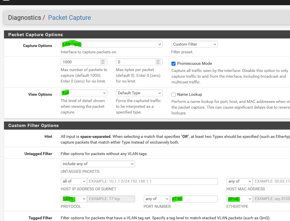

        The old way at looking DHCP info :
        Select the interface, with full details use UDP, ports 67 & 68, IPv4.
        Consider adding here :
        the MAC of the printer.
        Hit start.
        Reboot the printer.
        You should see DHCP traffic from the printer : first : the initial DHCP 'boot' lease, with the lease duration.
        Come back a little bit before '50 %' of the lease duration : you should see a lease renewal from the printer.

            Gertjan @terryzb
            @terryzb said in Printer losing its DHCP lease in 25.07.1:
            printer because with DHCP it would fail back to link-local after 6 hours or so
            So around 3 hours from the initial printer power up == initial 'BOOT' DHCP request, start some time before, like 30 minutes or so, like at initial lease+150 minutes, you should be able to packet capture with the printer MAC to see if pfSense actually receives a DHCP request from the printer.
