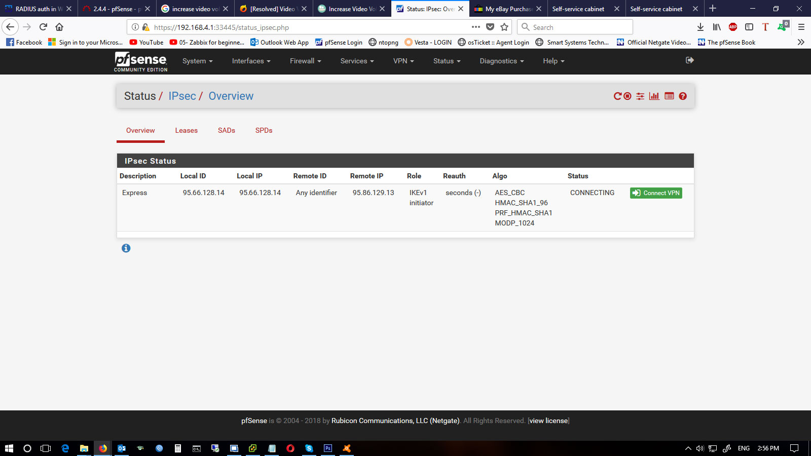

  • IPSec site to site VPN "Connecting" Status only
    234 Views
