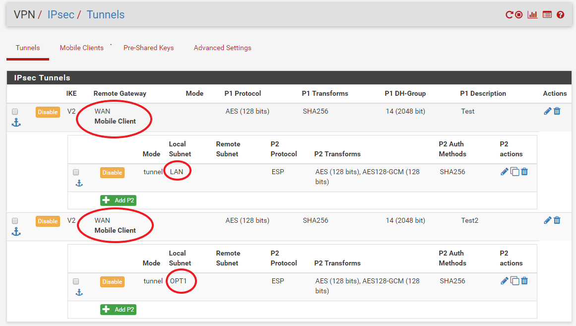

  • 2 mobile clients tunnels supported?
    567 Views
    That's a clear answer. Thanks Jim! :) Then i have to wait until my provider supports ipv6 native. It should possible with 2 pfsense then. Many Thanks Have a nice evening. Regards Alitai
