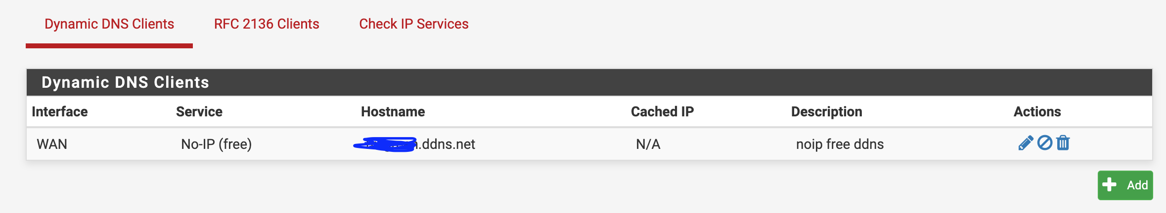

  • Dynamic DNS - Public IP gets set to a local address
    556 Views
    JKnottJ
    @miken58b said in Dynamic DNS - Public IP gets set to a local address:
    So a catalog of self-inflicted errors and I need to better understand why pfSense DHCP isn't allocating the same IP address consistently to the same client.
    Is the device turned off for a period of time? If off for longer than the lease time, there is no guarantee it will get the same address again. If powered up within the lease time, it should get the same address.
