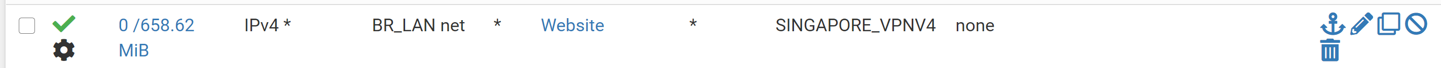

    Hello everyone, I myself resolved this case. Summary: Pfsense openvpn interface name: OVPN_TINH. Tunnel network: 10.0.8.0/24. Singapore provider's openvpn interface name: SINGAPORE. Aliases name is website include: whatismyipaddress.com, google.com I want to remotely access the VPN server on my pfsense box and then have my outbound traffic destined to "google.com" exit via the VPN client SingaporeVPN service provider. Firewall > NAT > Outbound. Add. Interface: SINGAPORE Protocol: any. Source: Network: 10.0.8.0/24 Destination: any. Save. Firewall > Rules > OpenVPN. Add (OpenVPN interface pfsense). Interface: OpenVPN_TINH Protocol: any. Source: OVPN_TINH net. Destination: Single host or alias: website Gateway: SINGAPORE Save. Apply changes. Result: From my laptop showed Singapore vpn wan ip: 89.187.163.119
