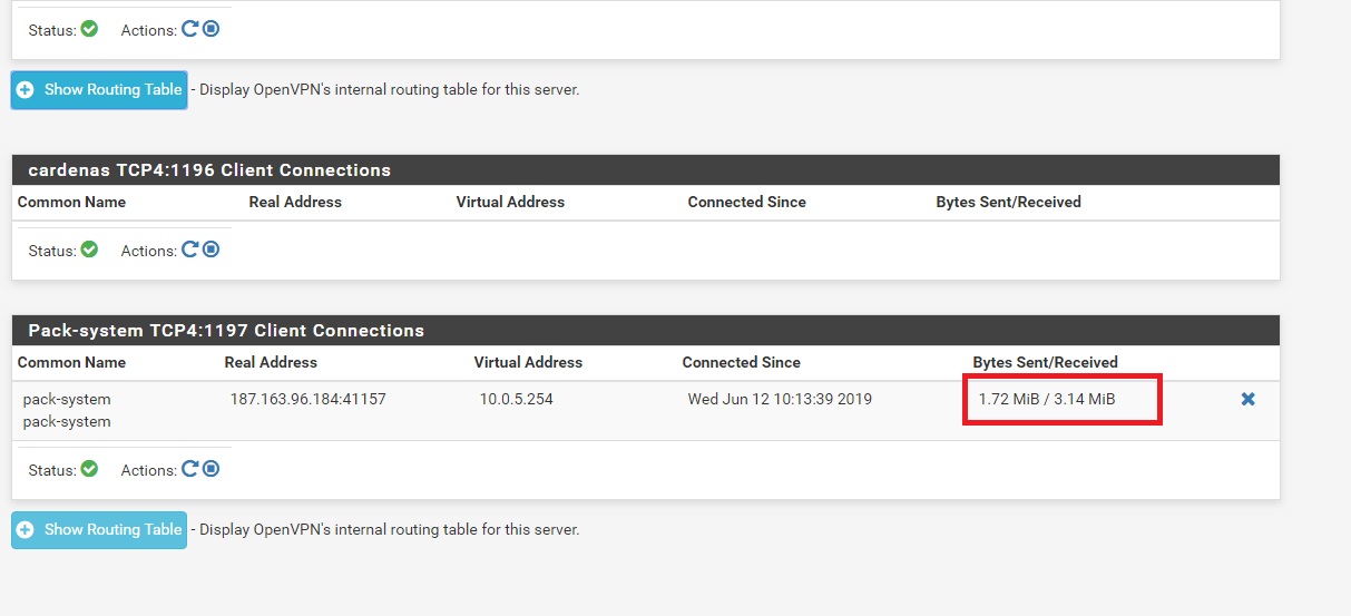

  • bandwidth consumption
    441 Views
    You may be able to do that using reneg-bytes in the custom options field. It depends how the client authenticates. If they have to enter a password, and the client does not retain it, they would need to reenter the password after the specified number of bytes. That's a sum of bytes up and down. Steve
