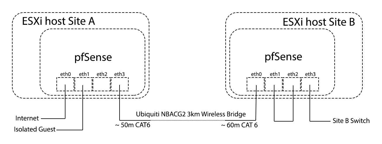

  • Double OpenVPN config on single network WAN>LAN>WAN2>LAN2
    477 Views
    DerelictD
    Honestly, in that case I would probably use IPsec. There really isn't enough information provided to make any recommendations. Need to know how the subnets are defined, etc. Zero idea what you are doing with that eth1 - eth2 loop at Site B, for instance.
