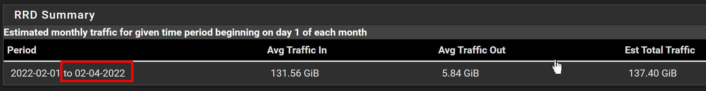

  • Oddness of Traffic Status, RRD Sumary and NTP...
    500 Views
    provelsP
    @stephenw10 Thanks. I will, and I think I've read that host time sync is only for maintaining the VMs time when the VM is off, but conversely it doesn't seem the host should loop with the VMs NTP either. I'll give it a try and delete all the present RRD data since it's corrupt anyway. Thanks again.
