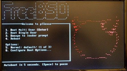

  • Is this legit boot screen or hacked pfsense?
    344 Views
    AKEGECA
    I am not sure what are you referring to, but you could participate on Fightback campaign against attackers. https://forum.netgate.com/topic/162424/fightback-campaign-against-attackers-your-participation-matters-%CA%95%CA%98-%CA%98-%CA%94 Edited:links
