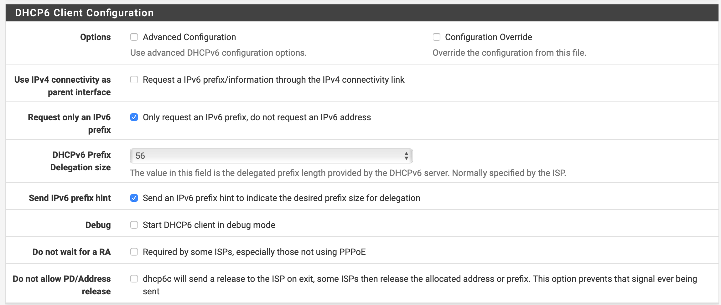

  • setup for server behind Comcast dynamic IPV6, VLANs, publicly reachable
    645 Views
    JKnottJ
    @lifespeed said in setup for server behind Comcast dynamic IPV6, VLANs, publicly reachable: Yes, I am well aware that Comcast's residential service with dynamic IP keeps the same IP address for months or even longer. There's a setting on the WAN page "Do not allow PD/Address release" that should be selected to prevent getting a different prefix. Have you selected it?
