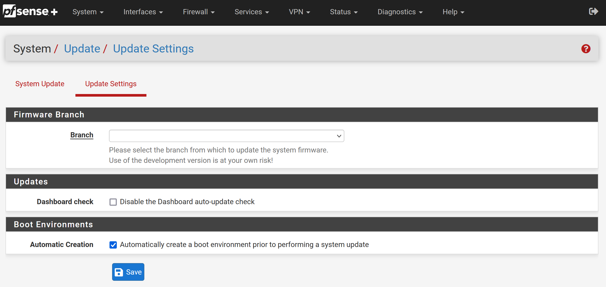

  • Upgrade to 23.01 results in empty firmware branches
    16
    16 Posts
    @mfld said in Upgrade to 23.01 results in empty firmware branches: This brings us back to my feature request that customer should have an unregister / force re-register option or the register option should automatically unlock when token is expired + expiry date should be displayed in GUI. I probably wrote that redmine... :)

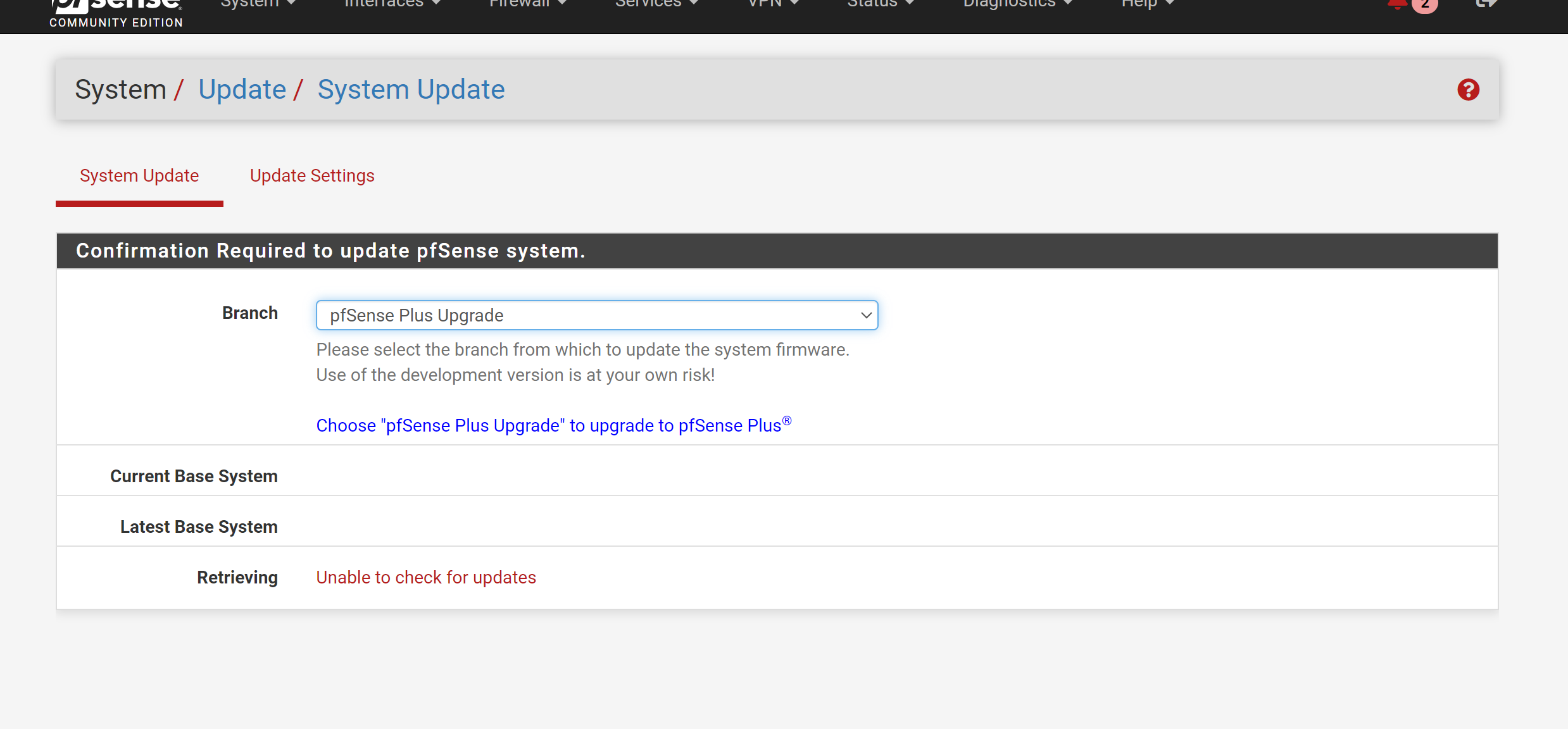

  • Upgrading from 2.6.0 to Plus - Unable to check for updates
    499 Views
    @daredevilbear said in Upgrading from 2.6.0 to Plus - Unable to check for updates: Any ideas on how to fix? Please open a ticket and include both your NDI and your Order Number https://go.netgate.com/
