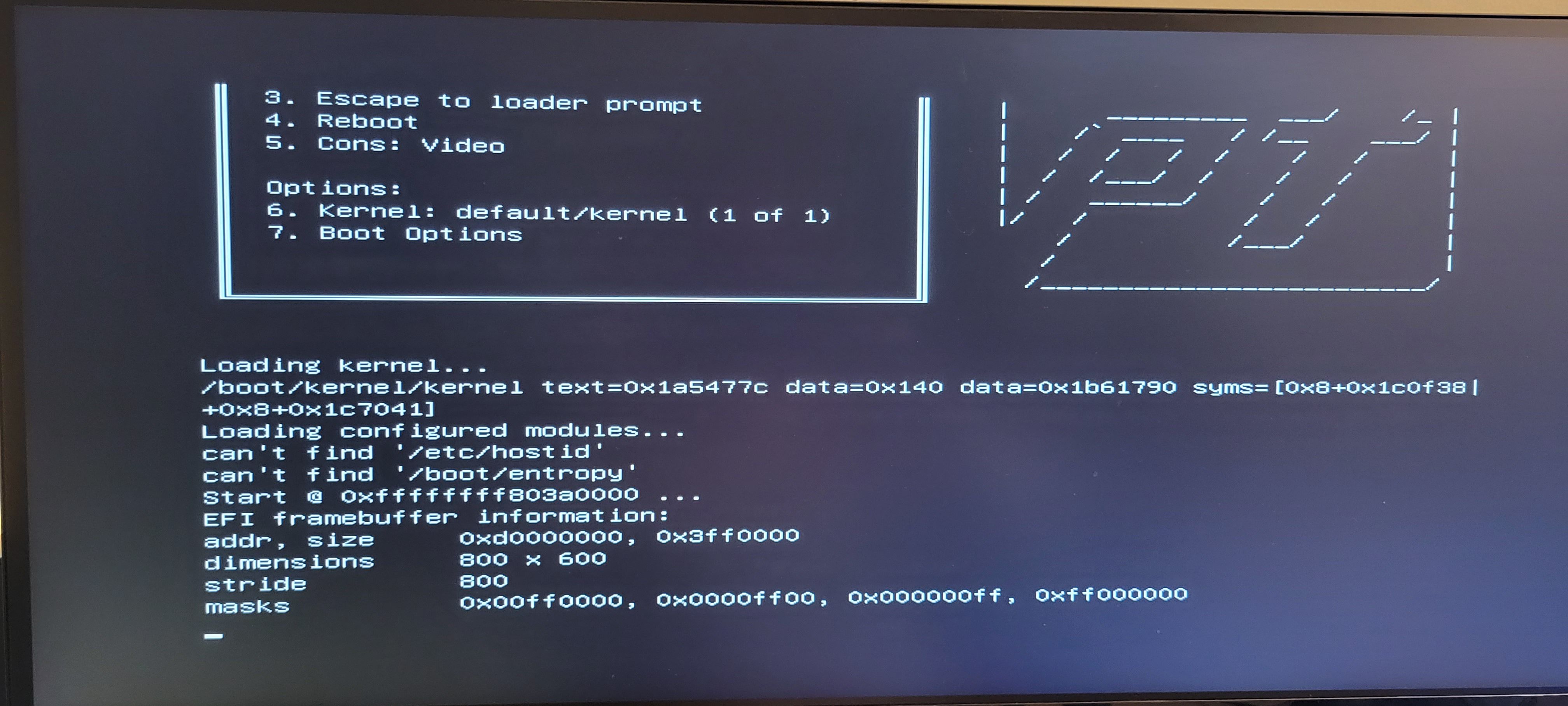

    @johnnyg_mi said in Installer fails, reboots PC, and repeat: I'm using pfSense-CE-memstick-2.5.2-RELEASE-amd64.img.gz just downloaded today. I flashed it to a USB drive, trying both Rufus AND Etcher, but I still have the same issue. After boot, I see the "Welcome to pfSense" menu and it automatically boots after 3 seconds. It starts to load but then reboots 3-4 seconds later. It simply repeats this cycle, never getting to the installer. I've installed other OSes on the same PC without this issue: CentOS Stream 8, Stream 9, and Debian 11. I have also tried downloading pfSense-CE-2.5.2-RELEASE-amd64.iso and writing/burning that to a DVD, but that has the same problem. Just before the PC reboots, I captured the errors in the attached image. I have also tried to intervene when the "Welcome to pfSense" boot menu appears; I have set "Cons: Video" (shows "Cons: Serial" by default) as well as attempting to boot in Single user mode. I have also used the Boot Options menu to set Safe Mode: On and Verbose: On, but I see the same result.[image: 1644105617095-20220205_184224-resized.jpg] See if this thread might help you out: https://forum.netgate.com/topic/161963/boot-from-install-media-results-in-can-t-find-boot-entropy. Others that have experienced this issue in the past had to change some BIOS settings to get around it. And at least one person I recall reading a post from some time back had to actually update the BIOS in his hardware device.

  • pfSense 2.5.2 install...Can't find /boot/entropy
    So...after scouring the web.... I found this: https://www.reddit.com/r/PFSENSE/comments/9l5fqo/422_upgrade_boots_up_yet_monitor_stuck_at_booting/ I proceeded to test, and yes, pfSense 2.5.2 does boot in legacy mode on the Zotax CI-323 to install, you are just unable to see it booting as the console output stops after you see the message can't find file '/boot/entropy'. The solution was shown in the above link to be: hit [esc] during initial pfsense boot. At the prompt, type "set kern.vty=sc" hit return At the prompt, type "boot" I was able to see the boot and prompts to install once this was completed. There is likely an issue with a kernel driver, but this solves the problem for now. Once I installed with the updated realtek driver, I my /boot/loader.conf.local config is as follows: kern.vty=sc if_re_load="YES" if_re_name="/boot/modules/if_re.ko" The system is now booting in legacy mode and I have the updated CI-323 driver 1.96_04 installed as a module. The system is stable. For what it's worth, I have used a pfsense Zotac CI-321 for more than 2 years with a recompiled kernel and loaded the updated realtek drivers in the kernel. This box achieves 1Gbps throughput routinely and hasn't been rebooted for months. I run it on AT&T Fiber for basic firewall with NAT. I will be recompiling the FreeBSD kernel to include the updated realtek drivers for the CI-323 as well with hopes of duplicating the performance I get on the CI-321. It's a shame we have to do this. I do agree with you. The Intel NICs are mostly painfree with respect to pfsense functionality. Realtek needs some love to get working properly.
