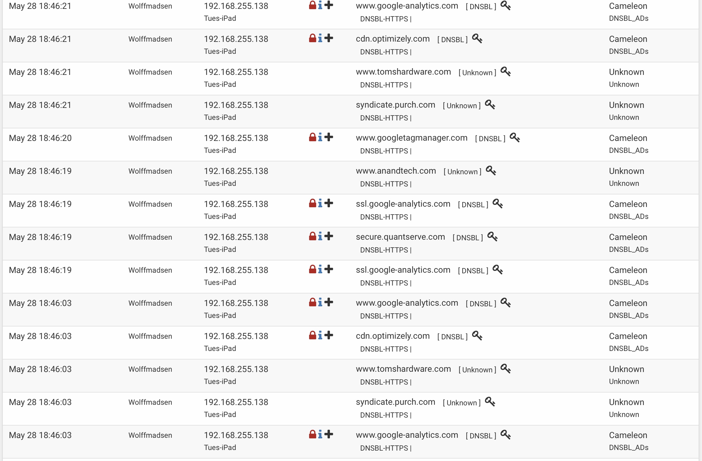

  • Page works but refresh or “next page” hits DNSBL - only on iPad
    606 Views
    keyserK
    Well yes, ofcourse it works if I disable DNSBL, and it also works if I whitelist e1151.e12.akamaiedge.net (which is my current workaround). I know pfb_dnsbl.conf is created at update time, but currently the akamai entry is included in the config because it is present in the SBL_ADs feed (Hence my need to whitelist it). So I still don’t quite get what you are reffering to - as far as I can tell it is an Apple issue because iOS the second time around decides to lookup the original A record (akamai) for which www.anandtech.com is a CNAME. It seems my PC continues to lookup www.anandtech.com.

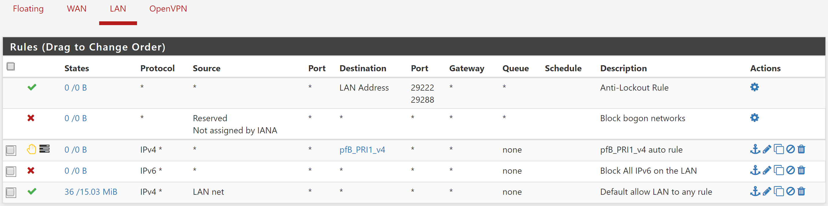

  • IP Block Firewall Rules?
    700 Views
    BBcan177B
    @fvultee When you created PRI2-4, Alias did you enable the individual Feeds? and set the "Action" setting?
